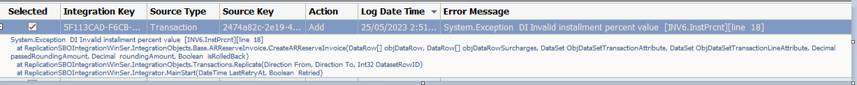

Integration Error DI Invalid installment percent value [INV6.InstPrcnt]
iVend 6.6 integrated with SAPB1
Transaction stucked from iVend to SAP with error message
" System.Exception DI Invalid installment percent value [INV6.InstPrcnt][line 18]"

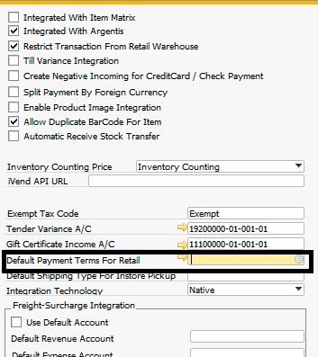

Suggested to check by below steps.
1. Stop the integration
2. Remove the default payment terms from retail settings and update
3. Start integration and retry the failed record.
IF Issue persist after above steps suggest to check by remove Third party addon if customer using.
