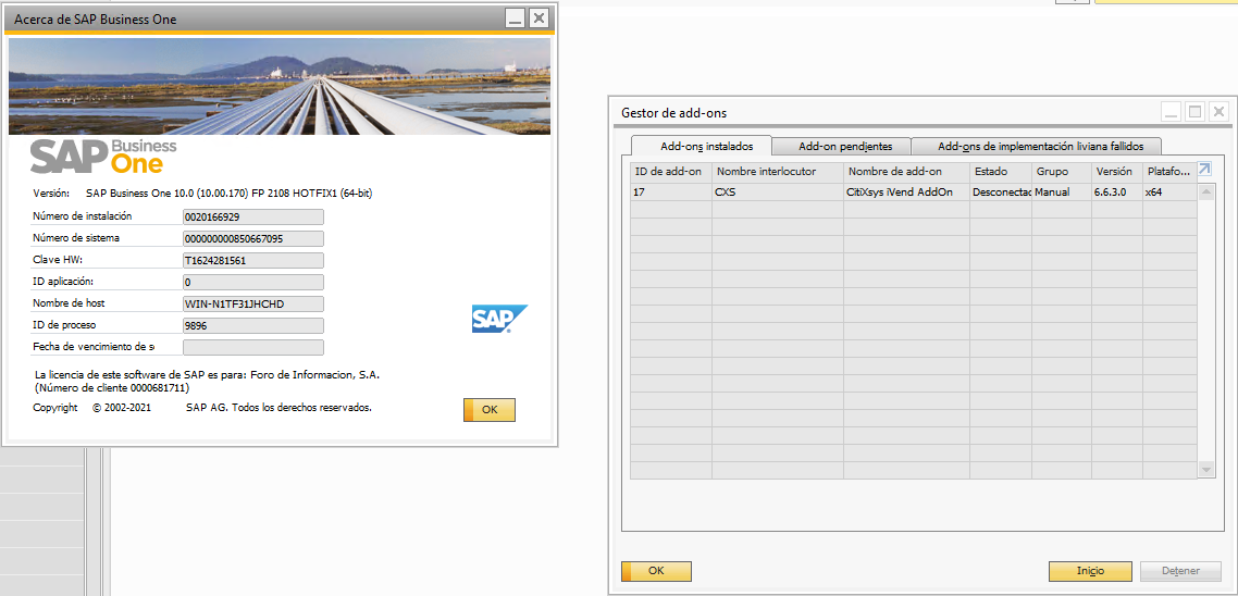

Unable to start iVend AddOn 6.6.3.0 x64 on SAP B1 10
When try to start iVend AddOn 6.6.3.0 x64 on SAP B1 10 Below error message showing:
User :manager, Method :, Error Message :DataBase Script Running at , Date :12/5/2022 09:59:36.
User :manager, Method :HandleIndexForiVend, Error Message :Table Name : OINV, Field Name : System.String[], ErrCode : -2035, ErrMessage : Esta entrada ya existe en las tablas siguientes (ODBC -2035), Date :12/5/2022 10:06:30.
User :manager, Method :Main, Error Message :Table Name : OINV, Field Name : System.String[], ErrCode : -2035, ErrMessage : Esta entrada ya existe en las tablas siguientes (ODBC -2035), Date :12/5/2022 10:06:30
Reason/Cause:
This problem has been found due to indexes was created in SAP Database through Sql query in SAP Database.
We recommend to fix this error with the SAP Partner first then after try to install iVend addon again.
We strongly recommend please never create any indexes directly using SQL query on SAP database.
