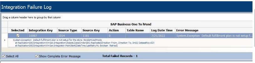

Issue
Integration failed record in Integration Failure Monitor from SAP to iVend, below is the error message:
System.Exception Default fulfillment plan is not setup for the store NoidaMixedMode at ReplicationSBOIntegrationWinSer.IntegrationObjects.SalesOrderSBO.Replicate(Direction From, Direction To, Int32 DatasetRowID) at ReplicationSBOIntegrationWinSer.Integrator.MainStart(DateTime LastRetryAt, Boolean Retried)

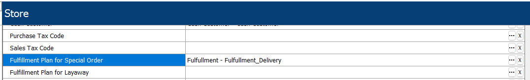

Resolution
Please check the below settings in Enterprise Management Console:
To open the window, choose Administration > Retail Configuration > Store.
Fulfillment Plan for Special Order | Select a default fulfillment plan from the list of plans. Click [...] to open the Fulfillment Plan Search screen and select the plan. Only delivery type of plans are allowed to be attached as the default fulfillment plan for special orders. To add a new plan, press F3 or click on [F3 New] button in the Fulfillment Plan Search screen.
This Field "Fulfillment Plan for Special Order" should be mapped with corresponding plan and after that retry the failed records in the Integration failure monitor to sync them.
