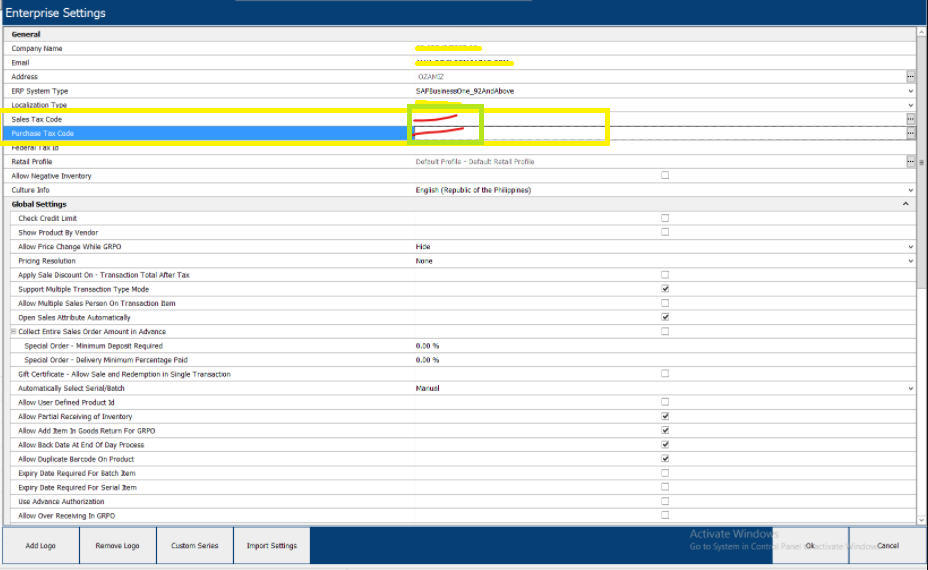

Tax Code Do not integrate in Ivend Managment Console From SAP
After Fresh installation of ‘iVend Enterprise Tax Code do not integrate in ‘iVend Management Console from SAP
Cause
It shows an error from the SAP side due to the incorrect date and time of the system.
Proposed Solution
After Update the correct date and time Records integrate successfully in to ‘iVend.
