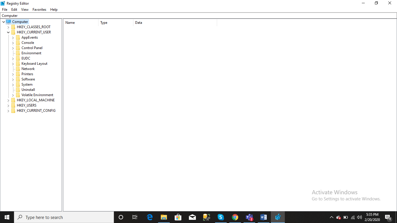

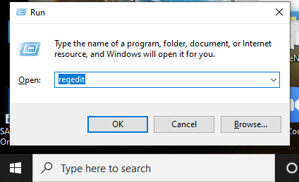

1. Type Regedit on the run menu.
2. Open -> Registry Manager-> Software
3. Chose FLEXlm License Manager option
4.Click on edit and change the License name on client server.
Constraints/Notes –: NA
