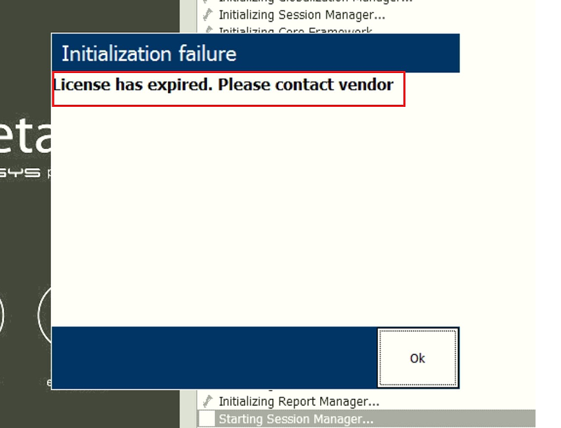

Getting the error "License Has expired. Please contact Vendor" while opening the Management Console.
Case Study:
Getting the error “License Has expired. Please contact Vendor” while opening the Management Console as shown below:

Resolution for this case Study:
In this case study, the customer had installed the License administration tool in both servers i.e. iVend Server and Database server.
Also the Expired License was present in the license tool at DB server and New license Was Present in the iVend Server. So the iVend was picking details of old License key which was present in the License tool at DB server. Below steps were followed to resolve the concern:
1- Returned the new license from iVend Server using Re-host option.
2-Uninstalled the License admin tool from iVend server.
3- Returned the Expired License from DB server.
4-Activated the New license key and issue got resolved.
