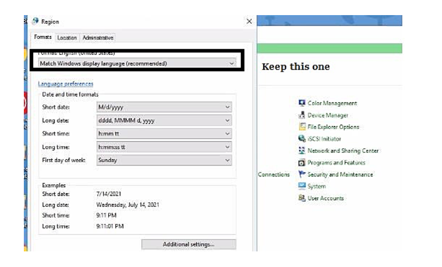

4) Check the local system setting . For this go to control panel open the setting “clock and region “then region
Path:-Control panel << clock and region <<Region

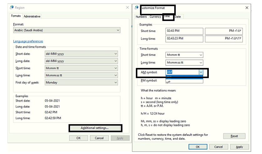

a) Now check the AM and PM symbol in customize format (refer the attached screenshot)
If the system is different rather than AM ( for morning )and PM )for "Afternoon/Night".)  then change the format in to AM and PM and check the result
b) Check the Date range. It should be more than License Expiry date . if license expires  on 2050 , End date should be 2075.
c) Check the format : Region screen

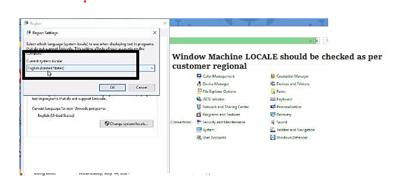

d) Check the machine locale

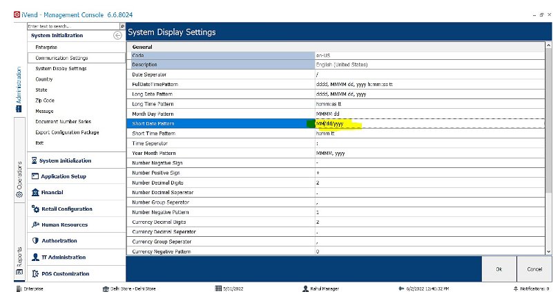

e) Check the date format : Date format should be MM/DD/YY  in Display setting  on HO MC and as well Store MC
