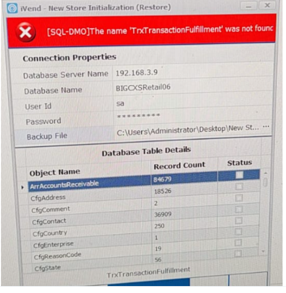

SQL Table was not found error during database restore on Store
Customer tried to restore the backup database from Enterprise on Store Server, the process failed because table TrxTransactionFulfillment was not found at the database.
Error Screenshot:
Resolution:
  • Verify whether any custom objects have been created in the Head Office (HO) database.
  • If custom objects exist, stop the Replication Service and drop the custom objects from the HO database after taking the backup.
  • Take a fresh backup of the HO Management Console (MC) .
  • After the backup is completed successfully, recreate the custom objects in the HO database.
  • Now try to Restore the backup from Store Server
