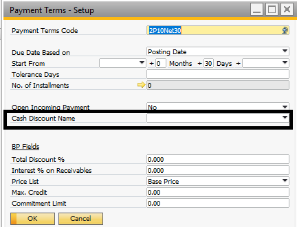

Error generally  occur when a Cash Discount Name is configured in the Payment Term, causing a discrepancy between the invoice amount and the payment amount being posted from iVend to SAP Business One.
In SAP Business One,  We require to verify the Cash Discount Name configured against the payment Term Against A/R Invoice. It should be blank.
Info
Steps:

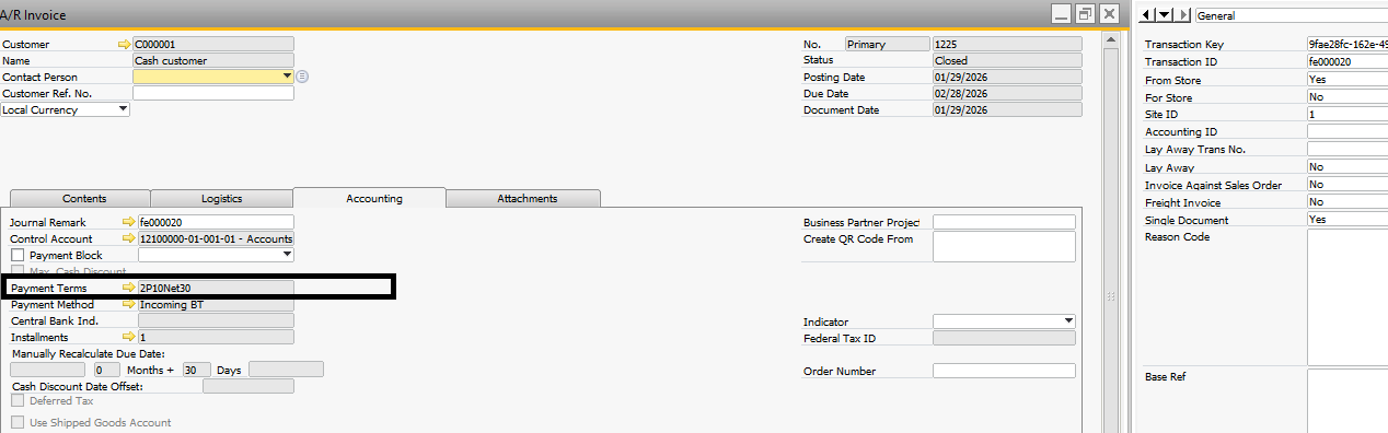

1.Open the A/R Invoice associated with the stuck Incoming Payment in SAP Business One.
2.Navigated to Accounting → Payment Terms.
3.Verified that a Cash Discount Name is configure against the assigned Payment Term.
4.Cleared the Cash Discount Name field and updated the Payment Term configuration.
5.Retried the integration process.
