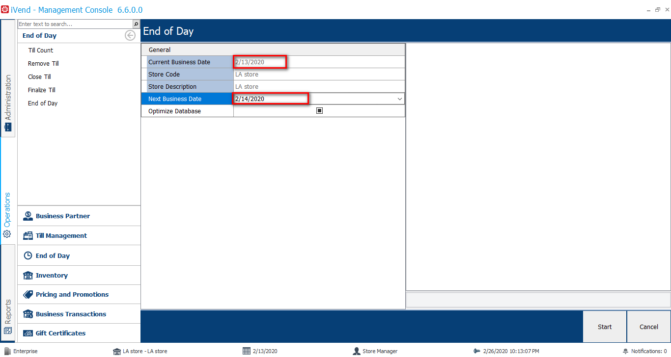

1-Current and next business dates can be seen at the End of the day screen as shown Below:

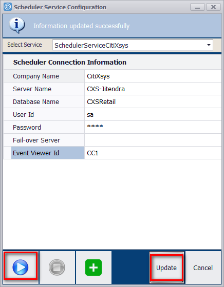

2- Select Scheduler Service Configuration.
3- Enter all details and update the Scheduler Service Configuration screen and Run the service as shown below:

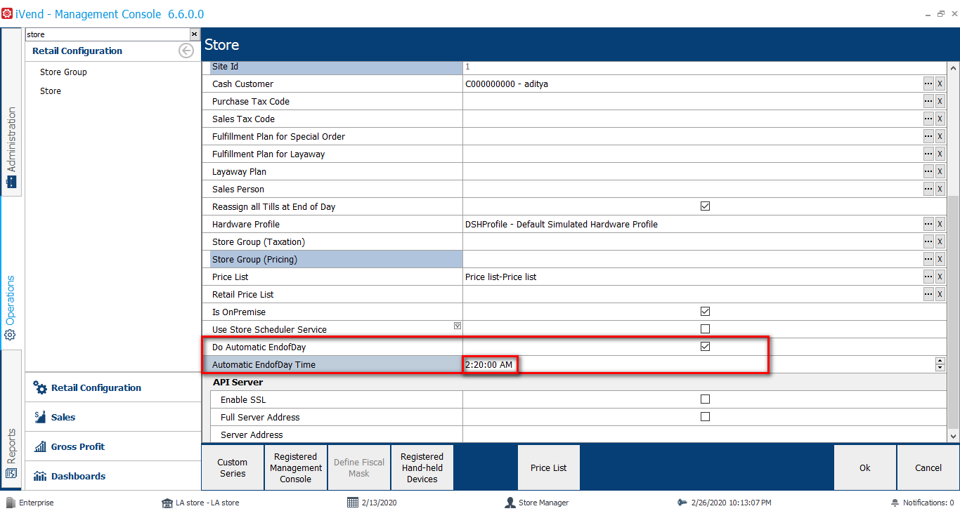

4- Go to Store and open the store and Check Do automatic EndofDay option. Once done, enter value in Automatic Endofday Time field and click on OK button as shown below:
5- With correct system configuration as above, EOD will trigger at scheduled time. You can verify the Current and next Business date from END of Day screen as shown below:
