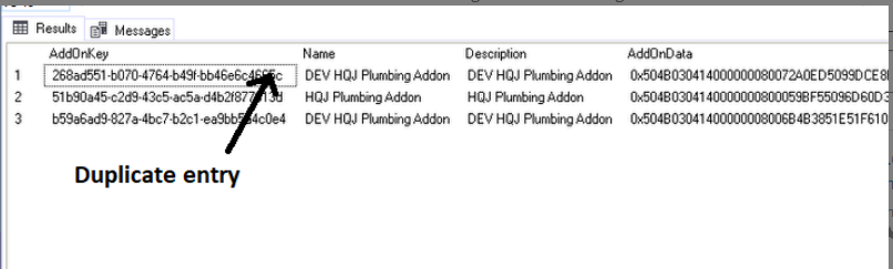

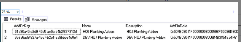

Look for the entry in table ‘cfgaddon’ and compare it with the enterprise DB.
In this case customer had duplicate entries in cfgaddon table in offline POS DB
Enterprise DB:
Offline POS DB:
After removing the duplicate entries add-on started to work successfully.
