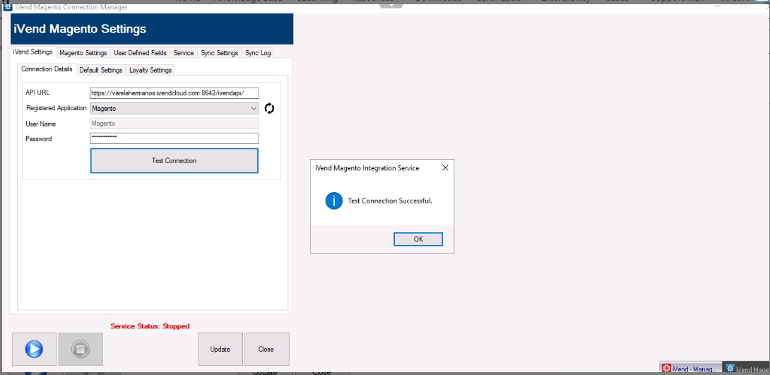

Error Alert showing
 This comes when iVend API is not working i.e. when the connector is trying to access the API and it is not responding. So Check the iVend API whether it is running. Check with connector also, as shown in the screenshot attached (Connector-iVend-API-Connection-Check.jpg).
