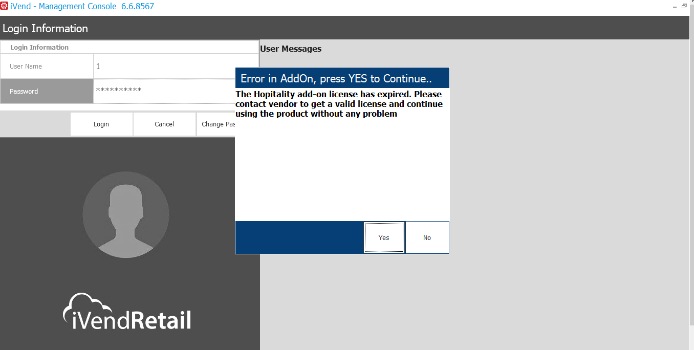

Error in AddOn, The Hospitality addon license has expired
iVend 6.6 8567
Customer facing bellow issue for the license , and license is available till next year, please find the below info.
We suggest to change the date format in the Management Console System Display setting and also change the system date format to MM/dd/yyyy.
Date Format Should be in the mention above Pic, make Sure the letter of Alphabet should be like this patter small and CAPS
