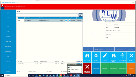

While doing sale getting an error"check the printer/cashdrawer status before payment"
Problem Statement:-
While doing sale transaction getting an error"check the printer/cash drawer status before payment"

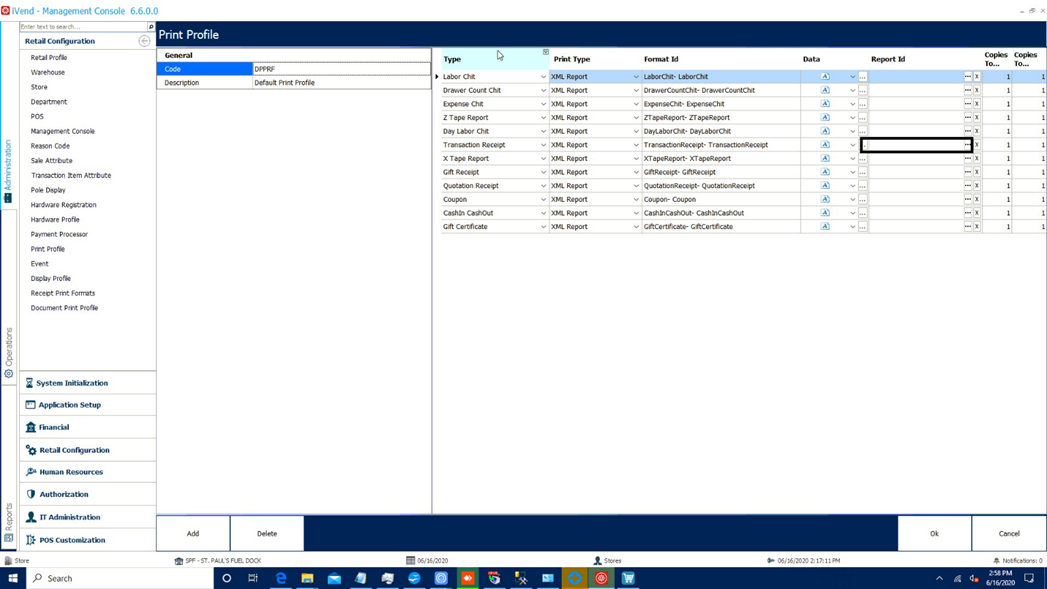

Proposed Solution:-
Go to print profile and check the mapping in transaction receipt filed
Follow the path :-Administrator<<retail configuration << print profile
Do not fill /select the report id field from the drop down list leave it blank
