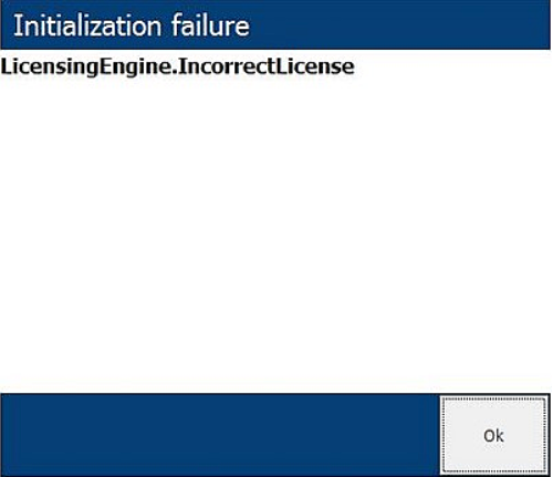

When opening Management Console then getting error "LicensingEngine.IncorrectLicense", below is the screenshot for the same:

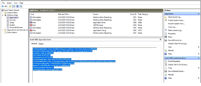

Machine Application log displays :-
Faulting application name: iVendLicensing.exe, version: 1.0.0.0, time stamp: 0xc6fb878d
Faulting module name: lmgract_libFNP.dll, version: 11.12.1.0, time stamp: 0x53216679
Exception code: 0xc0000005
