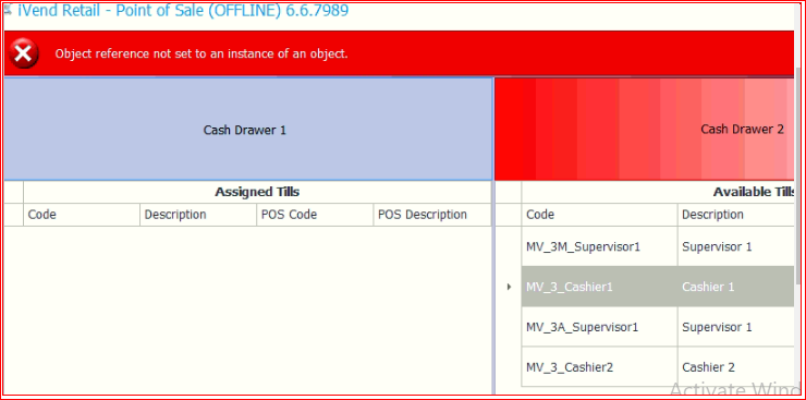

We are currently having issue while creating POS at Enterprise MC. We have check with our POS Custom Series, all been setup accordingly.
iVend 6.6 Patch 7989
Below error message is reflecting at the time of starting the POS.
"Object reference not set to an instance of an object"
Solution
1) At Store, need to check the Is On-premise box in order to proceed with POS creation.
2) Open Store MC -> Check for the IsOnPremise option is enabled or not if not enable enable it.
After enabling the store MC Is On-premise option the issue was resolved.
