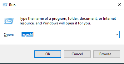

1: Press Window + R button. And then type Regedit press Enter.

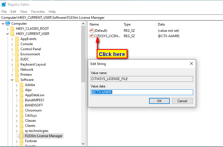

2: Expand: HKEY_CURRENT_USER >> Software >> Click on FLEXlm License Manager.
3: Click on _CITIXSYS_LICENSE_FILE right panel and enter correct SQL server license serer machine name then press OK button. Then try to login in Management Console.
