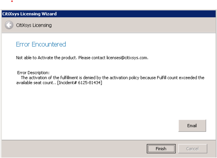

Unable to install New license file.
Error message appears while activating new license file, below is the screenshot for the same:
Cause:
Trying to activate single server activation License again at another server.
Resolution:
Production license is for single server activation, so need to return the license from old server and activate the same key on the new server.
