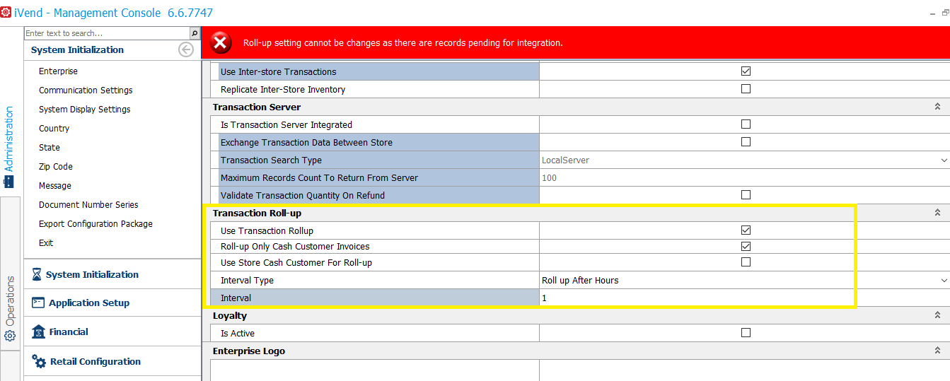

Unable to active Transaction Roll-up in IVend.
Getting Error: Roll-up setting can not be changes as there are records pending for integration.
When changes are tried to be saved, it gives below error "Roll up setting cannot be changes as there are records pending for integration"
Cause:
Records show stuck in  integration monitor.
Proposed Solution/Workaround:
As message clearly suggests, for Transaction roll up to be configured it is must , that there should not be any records pending for integration.
