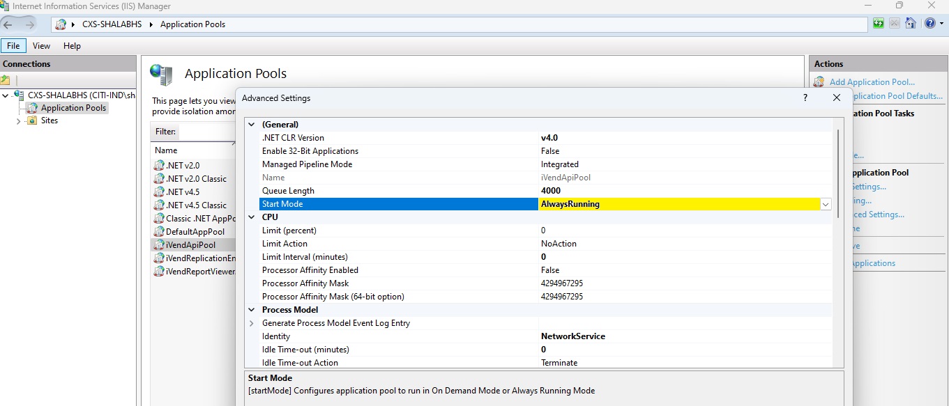

IIS--> Application Pool-- > iVendAPiPool--> Advance setting | (General) - Start Mode= AlwaysRunning
IIS--> Application Pool-- > iVendAPiPool--> Advance setting | Process Model - Idle Time out(minutes) =0
IIS--> Application Pool-- > iVendAPiPool--> Advance setting | Recycling -Regular Time Interval(minutes) = 60 ( default was 1740)
IIS -> CXS-SHALABHS--> Sites -->Default Web site -->iVend API --> Advanced Setting -->PreLoad Enabled= True
