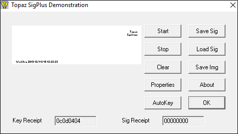

Step 5. Once the installation is complete, run the DemoOCX.

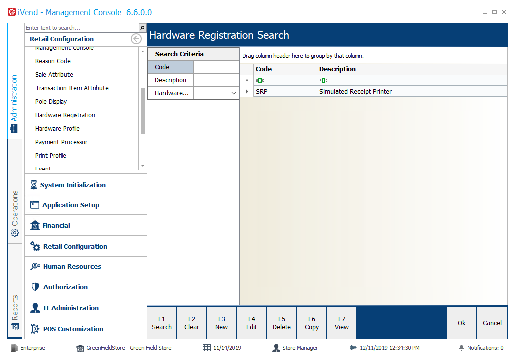

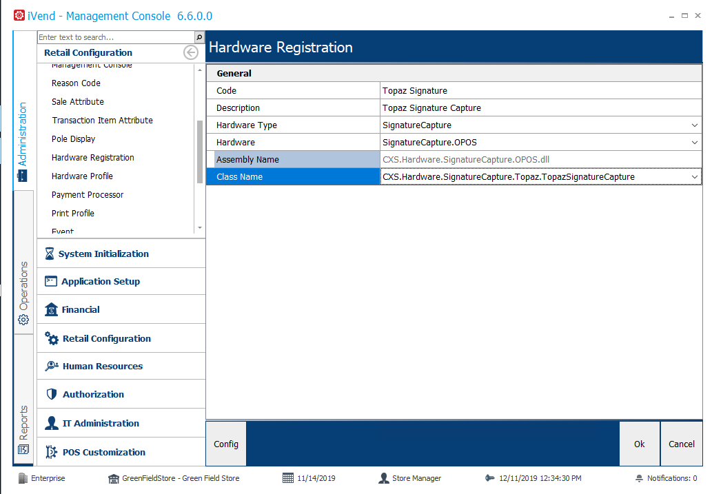

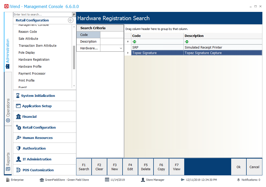

Step 1. Open iVend Management Console, go to Administration àRetail Configurationà Hardware Registration.
Step 2. Click on the F3 New button to add and register new hardware Topaz Signature Pad Model T-S460-HSB-R. Enter the code, Description, select the Hardware type, Hardware, and class name as shown in the screen.
Step 3. Click on Configure to update General Settings.
Step 4. The Topaz Signature Pad Model T-S460-HSB-R gets registered in iVend Retail and is displayed on the Hardware Registration Search page.

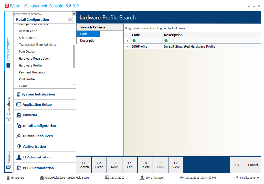

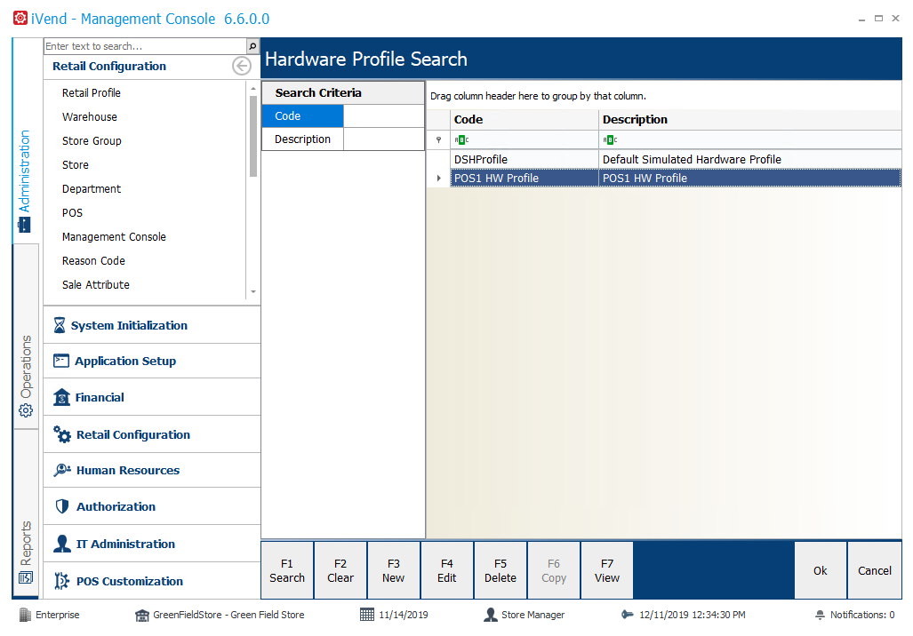

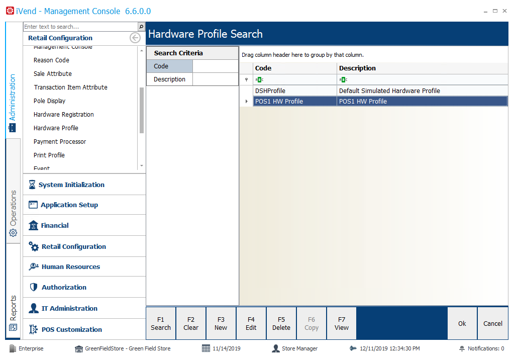

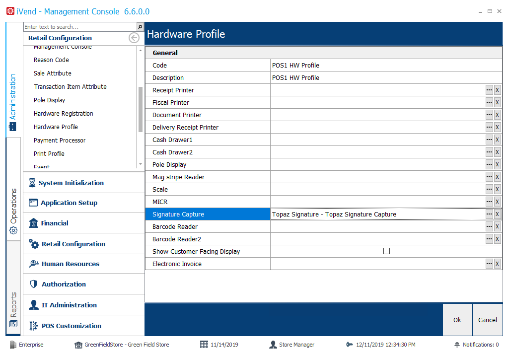

Step 5. Create / Edit a Hardware profile to add Topaz Signature Pad Model T-S460-HSB-R to the profile.

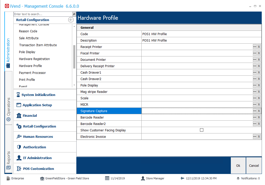

step 6. In the Hardware profile click on the ellipses for Signature Capture.
step 7. Select the Topaz Signature from the Hardware Search.
Step 8. The Topaz Signature is selected and displayed as the Signature Capture in the hardware Profile.
Step 9. Click on Ok button to save the hardware profile with the Signature Capture

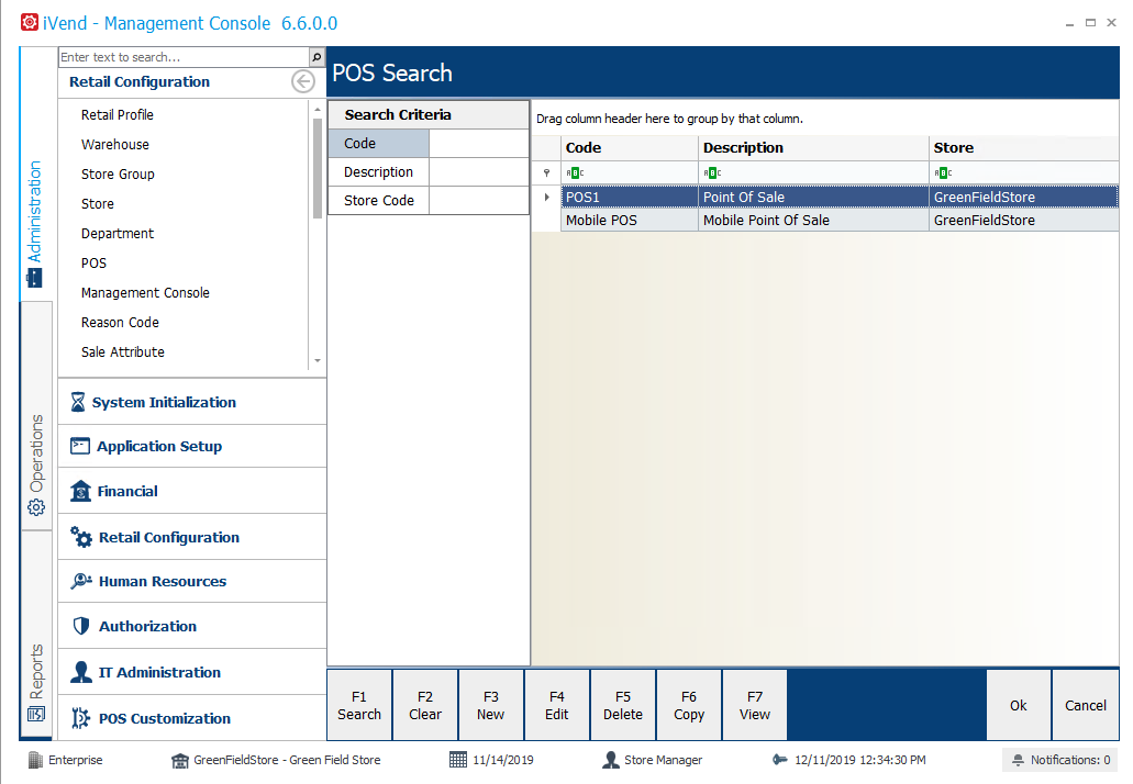

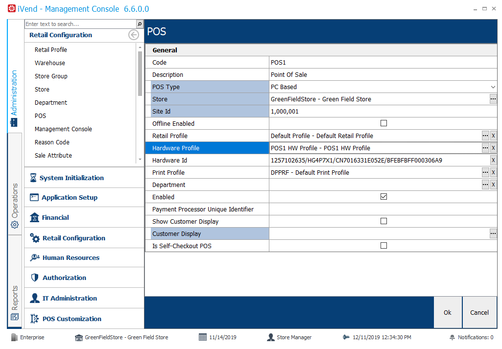

Step 1. Open iVend Management Console, go to Administration àRetail ConfigurationàPOS.
Step 2. Open the POS to which the Signature pad is to be attached. Select the Hardware profile which has Signature Pad attached to it.
Step 3. Hardware Profile with Signature Pad attaches to the POS.

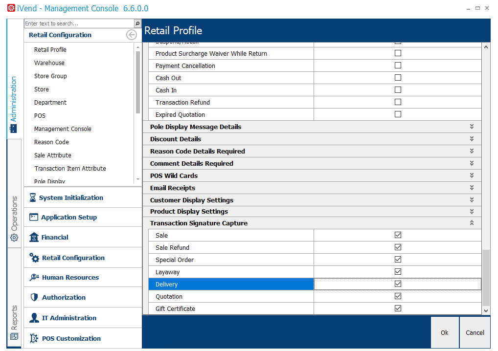

Step 4. In the Retail Profile Select the option available for Transaction Signature Capture.

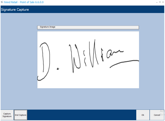

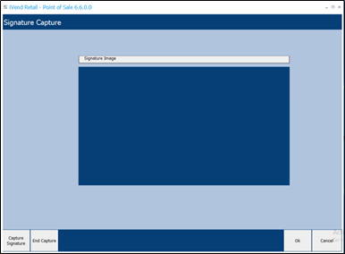

Step 2. Click on the Payment. Signature Capture window opens. Using the Topaz Signature Stylus, sign on the signature pad.
Step 3. The signature appears on the Signature Image screen.

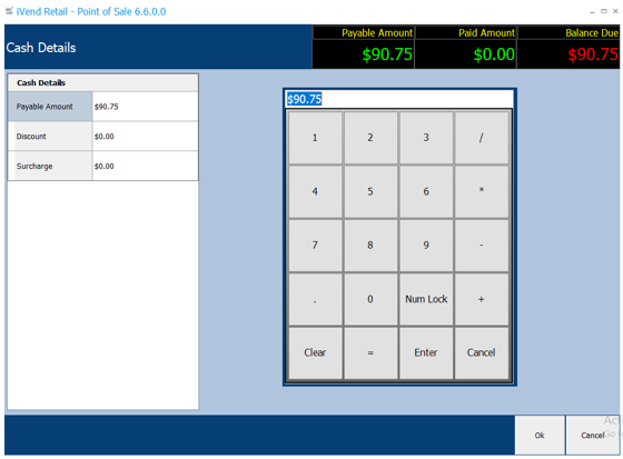

Step 4. Select the Payment Option. For the purpose of explanation Case Payment option is used.
Step 5. Click on Ok and complete the sale transaction using the Topaz Signature Pad.
