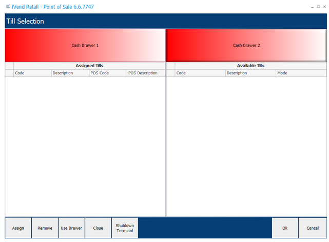

Issue
Till is not Showing in POS, customer created a new store location, and configuration/installation is completed. But facing issues with the Till. The Till is not showing in POS after logging in to the POS system.

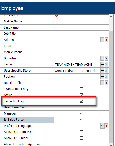

Corresponding Employee was not marked True for the "Team Banking" option, once the employee was enabled for the team banking issue got resolved. Below is the screenshot for the same:
Once users were marked for the team banking issue got resolved.

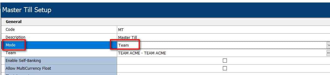

Note: Mode for the corresponding Master till was "Team" hence Team banking option should be enabled in the employee screen. Below is the screenshot for the same:
