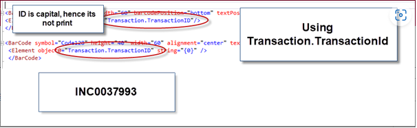

The Barcode is not printing on the transaction receipt
Problem statement
Product version
iVend 6.6 Patch 7685
Proposed solution
The transaction Id was incorrectly added on receipt (ID was in caps while it should be in id)
