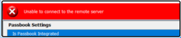

Problem Statement: -
Getting an error message "Unable to connect to the remote server" while doing Test SMS (SMS Integration).

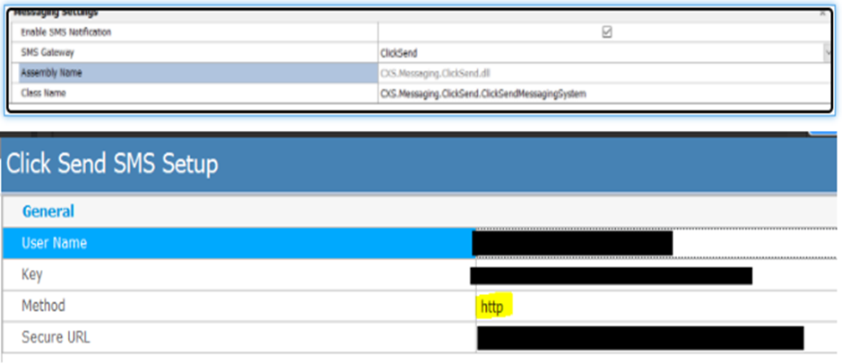

7. go to: Administration > System Initialization > Communication Settings and check Messaging Settings.
8. Check the SMS Configuration and for "ClickSend" SMS Gateway Method  should be "http"
