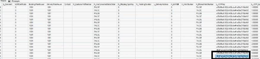

Pick the source key from the integration monitor and check the Uom Key from Integration_Transaction procedure.
Info
             exec Integration_Transaction 'Source Key'

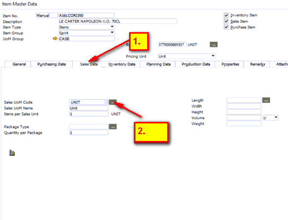

Open SAP and goto Main Menu >> Inventory >> Item Master Data
Open the problematic Item Master Data (One can get the item code from Integration_Transaction procedure).

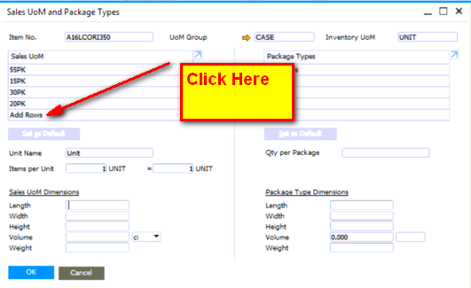

Click on the Sale Data tab, then expand the sale UOM list.
  • Info

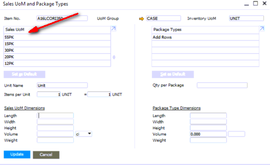

    The  UOM code from the above query should be available under the Sales Uom list of the Item in SAP
Info
In case the UOM is not available in the list, then scroll down the list and click on the Add rows and add the Missing UOM code.

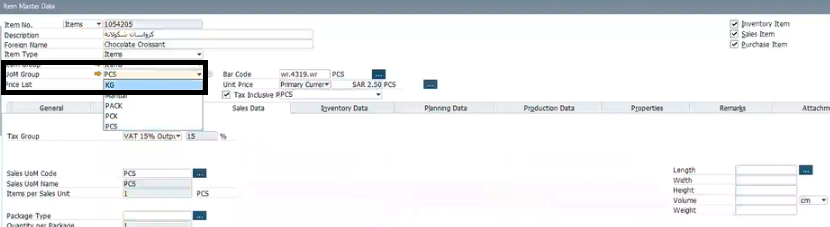

 Also check Uom Group associated in SAP it should be same as Uom shown on exec Integration_Consolidated_Transaction
