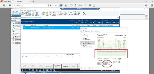

Problem Statement: Store server performance daily issue at 12:00 AM. At midnight the store server performance becomes very bad and it is found that SQL server service consumes the I/O resources especially the hard disk. The disk response time goes in millions.
Error Screenshot:
Symptoms: The store server performance becomes very bad and it is found that SQL server service consumes the I/O resources especially the hard disk. The disk response time goes in millions.
There is a job that clears all replication logs except for last 15 days. This job is executed every midnight at 12:00 am. When this job executed store server is stuck because of high consumption of I/O resources.
Solution: -
Changes in the replication web configuration is done to execute the job at 03:00 am (stores downtime or when the customer footfall is very low) instead of 12:00 am and the replication logs were cleared except of last two days.
Below are the parameters which were changed in configuration file.
********************* Old Configuration **************************
<add key="RunReplicationCleanJobAtTime" value="0" /> *** This is in 24 hr format.***
<add key="CleanReplicationDataSendLogAfterDays" value="15" />
<add key="CleanReplicationReceiveDataLogAfterDays" value="15" />
*********** The above parameters should be changed to ***********
<add key="RunReplicationCleanJobAtTime" value="3" />
<add key="CleanReplicationDataSendLogAfterDays" value="2" />
<add key="CleanReplicationReceiveDataLogAfterDays" value="2" />
