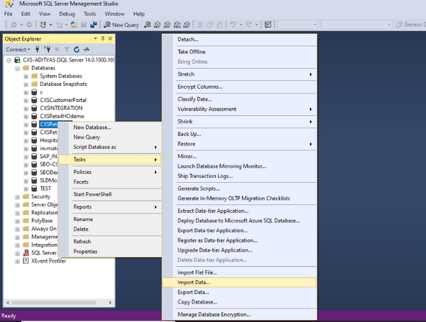

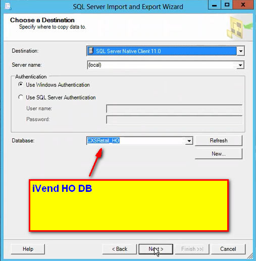

- Open the SQL server of iVend HO
- Right click on the HO database >> Tasks >> Import data.

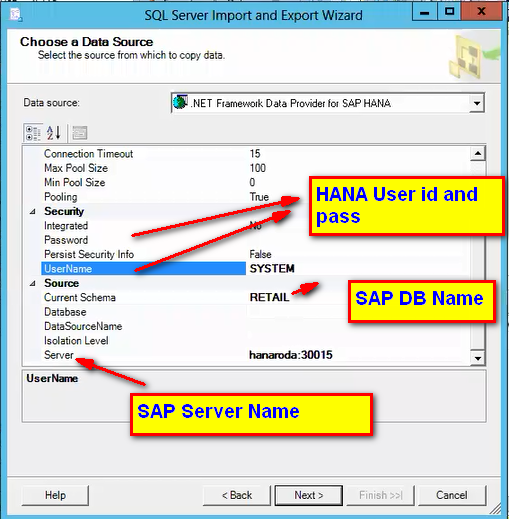

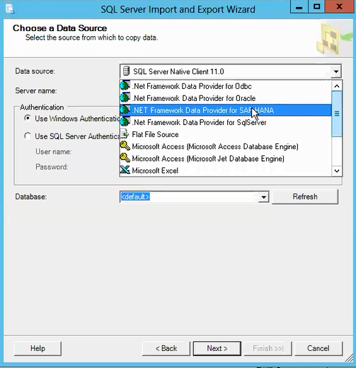

- Choose option .NET Framework Data Provider for SAP HANA, if the SAP DB is at HANA
- Refer below options detail
- Current Schema: SAP DB NAME
- Server: SAP Server Name
- User Name: HANA User ID
- Password: HANA PAssword
- You can get this info from iVend configuration manager

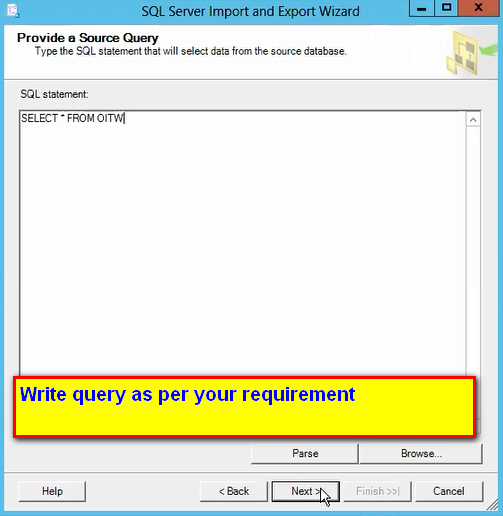

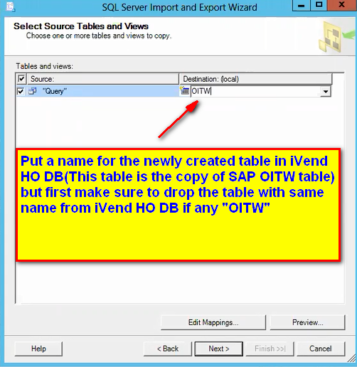

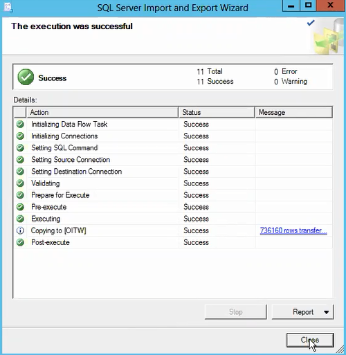

The above steps had a copy of the OITW table imported from HANA DB to iVend (SQL) DB.
Similarly, you can call/import other table data from HANA database for the requirement.
Once done you can continue the task at hand in the iVend HO database itself.
