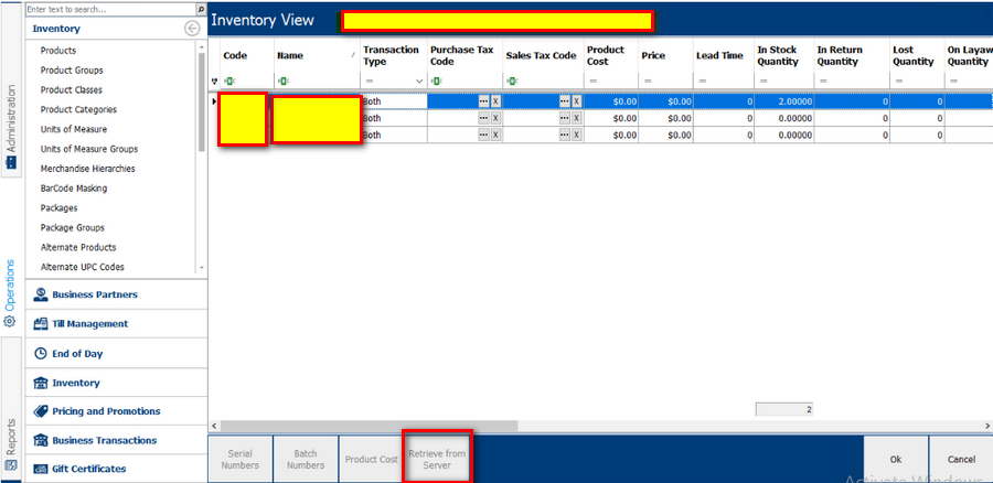

Steps to enable the "Retrieve from Server functionality"  button at the Store server. (Path : MC > Operations> Inventory > Select and view Product > View Inventory Button)
Or : - Getting below error while using Retrieve from Server functionality at Store Server.
"Inventory Status updated from enterprise server failed"

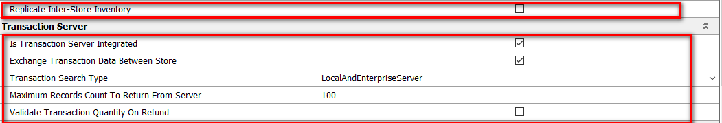

1. choose Administration > System Initialization > Enterprise and look for the Header Transaction Server
2. Checked the checkbox Is Transaction Server Integrated
3. Transaction Search Type should be Local And Enterprise Server.
4. Maximum Records Count To Return From Server should not be more than 100.
5. Replicate Inter-Store Inventory should be Unchecked.
