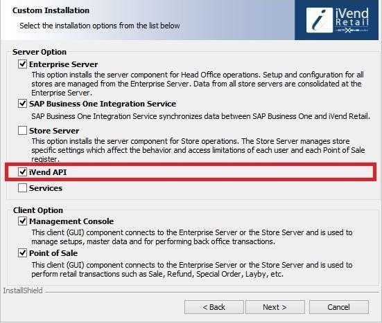

1. Depending upon the source database for the queries/reports, install the iVend API on the Enterprise and/or Store server. As a rule of thumb, the iVend API needs to be installed on the source server for iVend queries and reports.
Note: Ensure that a Public Static IP is assigned to the iVend API host server.
Figure 1 – Custom Installation Screen

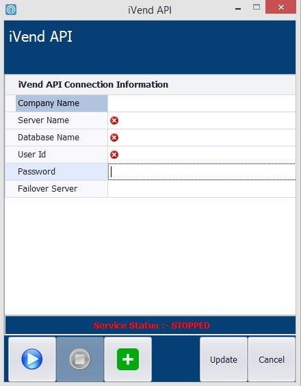

4. The iVend API window appears.
Figure 4 – iVend API Window Screen
Enter the required details in following fields:
Server Name: Enter the IP address of the iVend API host server.
Database Name: Enter the source database name on the iVend API host server.
User Id: Enter the SQL DB User ID.
Password: Enter the SQL DB password.
5. Choose [Update] to save the changes.
6. Choose the [Start] icon to start the API services.

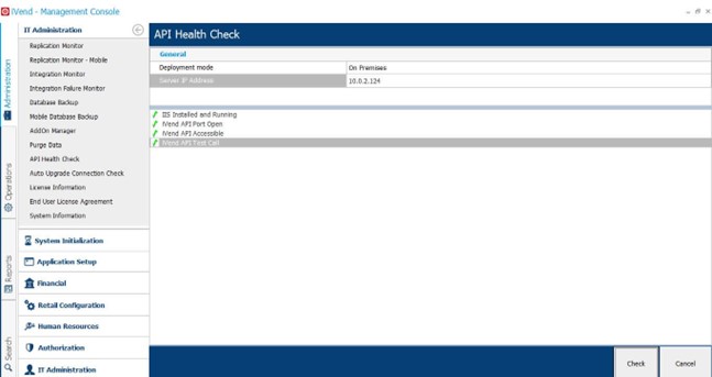

7. Log into the Management Console on the API host server and go to Administration > IT Administration > API Health Check - the API Health Check window appears.
8. Enter the API host server IP in the Server IP Address field and choose [Check] to initiate the API Health Check.
Figure 5 – API Health Check Screen
Note: When all checks are marked green, the iVend API is configured successfully.

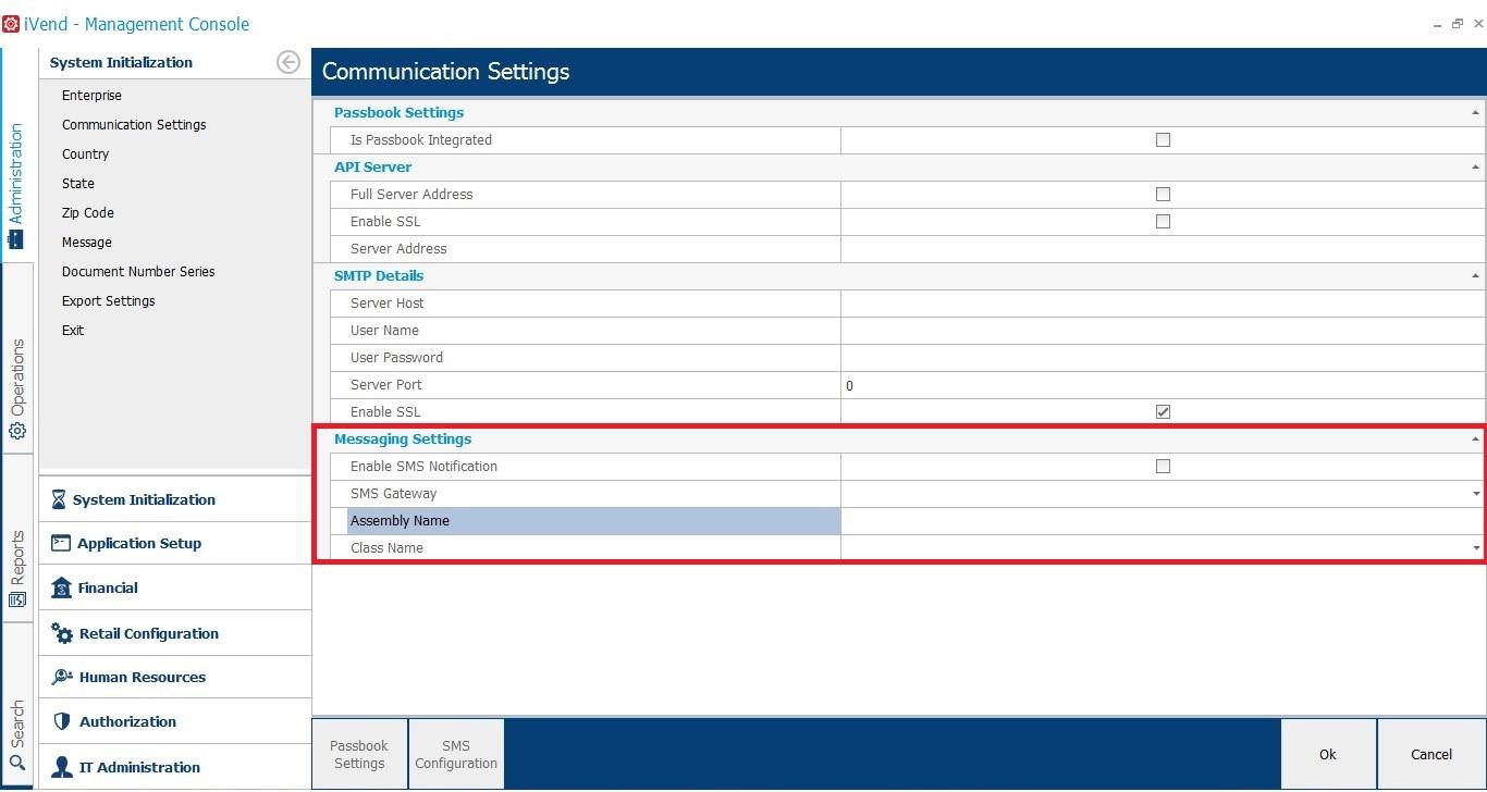

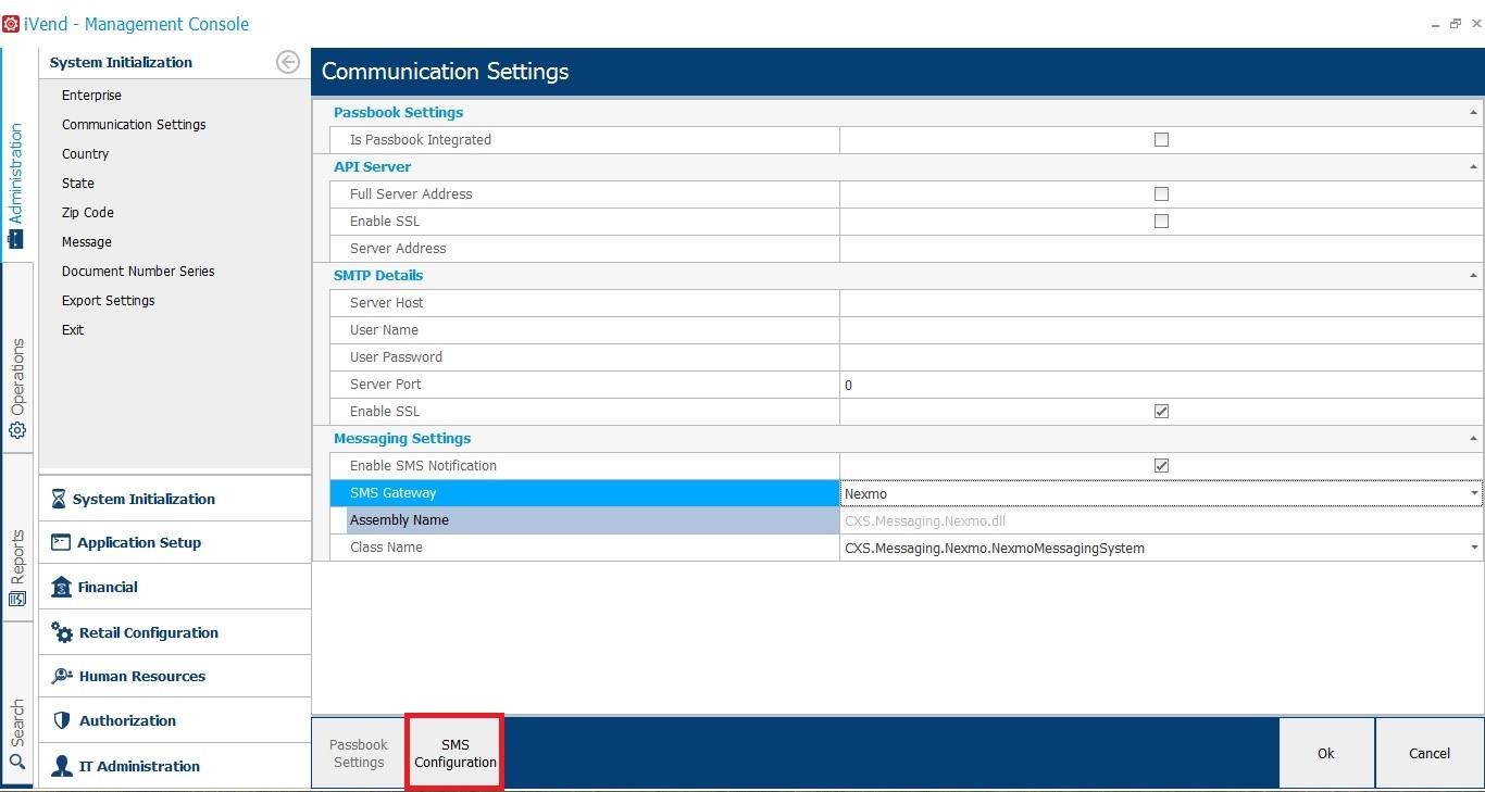

1. Log into the Management Console and go to: Administration > System Initialization > Communication Settings. The Communication Settings window appears.

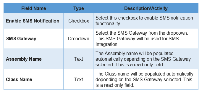

2. Enter the required values in the fields as shown in the table below, in the Messaging Settings section:
Figure 6 – Communication Settings Screen
3. On selecting the Enable SMS Notification field and selecting a SMS Gateway, the [SMS Configuration] button is enabled.
Figure 7 – Communication Settings Screen

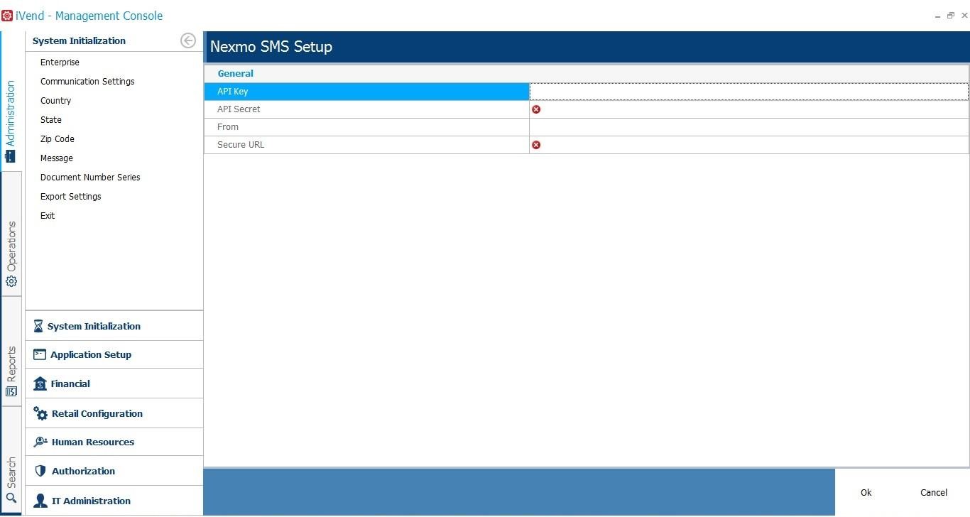

4.Click on the [SMS Configuration] button. Depending on the SMS gateway selected in the SMS Gateway field, the corresponding SMS setup window appears and the fields on this screen may differ depending upon the SMS Gateway selected.
Figure 8 – Communication Settings Screen
5. Enter the required values in these fields.
Note: The details required for these fields will be provided by the SMS Gateway Company.
6. Choose [Ok] to save the changes. The Communication Settings window reappears.
7. Choose [Ok]to save the changes made. The SMS Gateway configuration will then be saved in iVend.

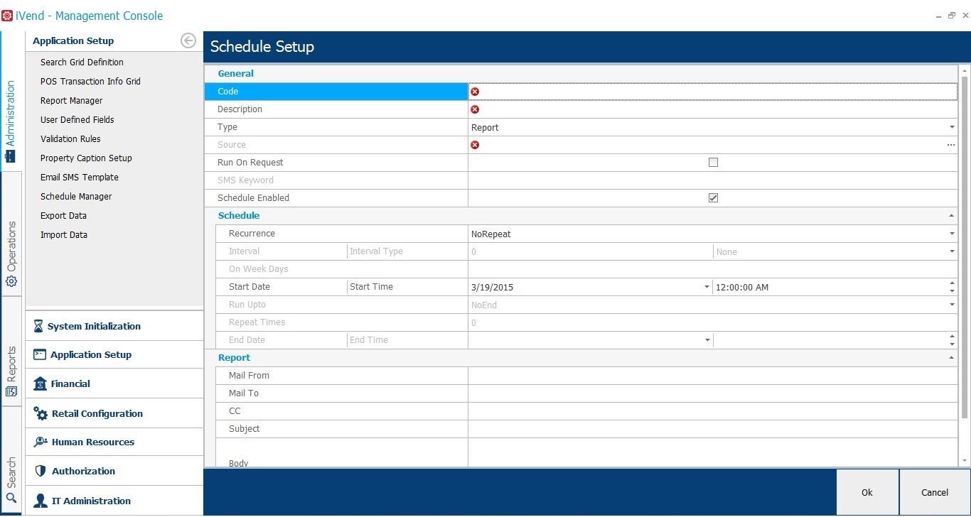

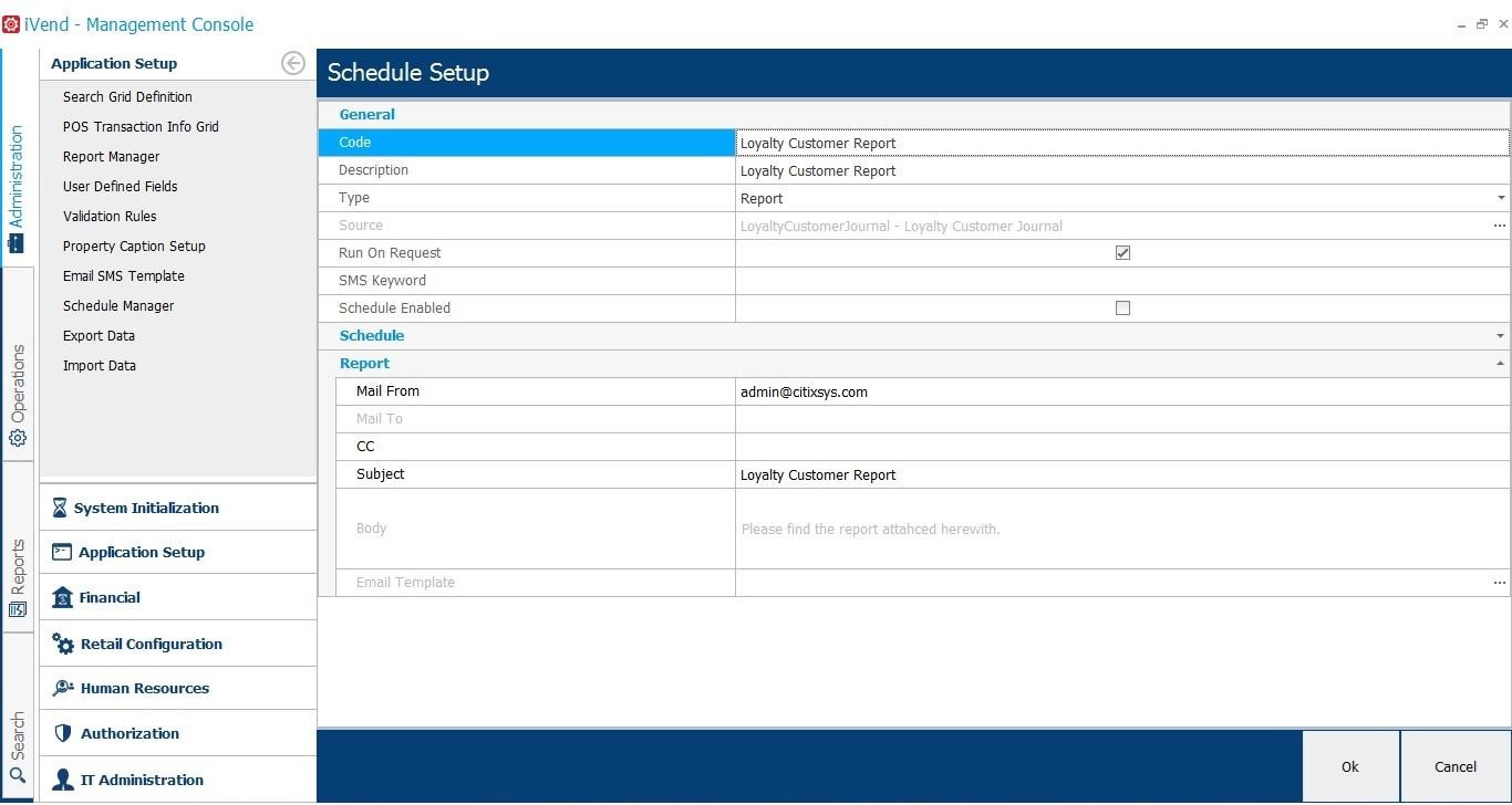

1. Log into the Management Console and go to: Administration > Application Setup > Schedule Manger. The Schedule Job Search window appears.
2. Press [F3 New] to setup a new schedule. The Schedule Setup window appears.
Figure 9 – Schedule Setup Screen

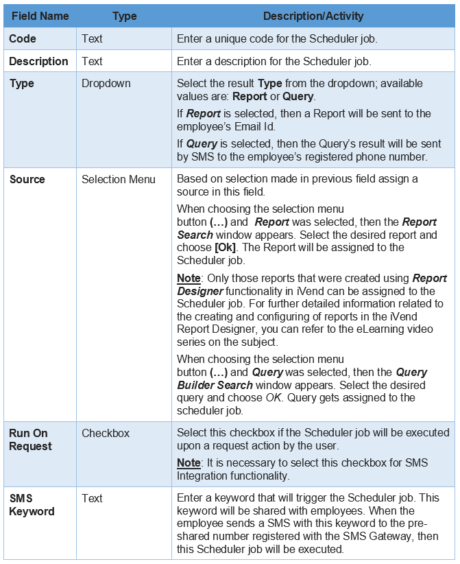

3. Enter the required data in the fields explained in the table below, in the General sub-section:
4.The Schedule sub-section is not relevant for SMS Integration; you may leave it blank.

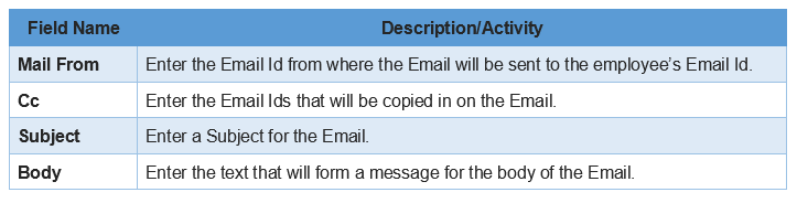

5.The Report sub-section is relevant for SMS Integration if Report was selected in the Type field. Enter the required data in the fields as explained in the following table:
Figure 10 – Schedule Setup Screen
6. Choose [Ok] to save the changes made.

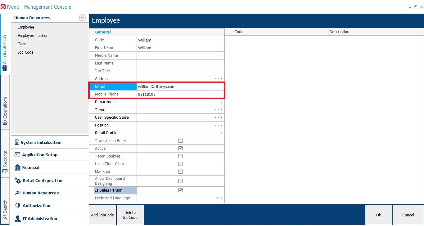

1. Log into the Management Console and go to: Administration > Human Resources > Employee - the Employee Search window appears.
2. Select the Employee record and press the [F4 Edit] button to open an Employee’s master record in edit mode.
Figure 11 – Employee Setup Screen
3.Enter their Email Id in the Email field and their mobile phone number in the Mobile Phone field.
Note: For SMS integration, the mobile number is mandatory. The Email Id is required for Emailing reports.
