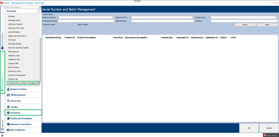

Log into the iVend Management Console and navigate to: Operations> Inventory
>Serial number and Batch management - the Serial and Batch Management
screen comes up. On the serial number and Batch management screen perform a
product search.
Figure 1 – Serial Number and Batch Management Screen
The following are options available to perform product search on this screen:
Field
Description
Product code
from
Product code starting from serial number / batch. Click on the
selection button to search the starting code number
Product code
to
Product code ending with serial number/ batch. Click on the
selection button to search the ending code number.
Product Group
Group to which the product code belongs. Click on the selection
button to search the group to which the product belongs.
Purchasing
document
This is either Goods Receipt Purchase order or Goods return.
Sales
Document
Select the transaction type from Sale, Refund, Layaway, or
fulfillments
Inventory
Inventory where the product belongs this could be Goods
Issued, Goods Receipt, Stock Transfer Shipment.
Serial Tracked
Select the checkbox, if the product searched has serial number.
Batch Tracked
Select the checkbox, if the product searched belongs to a batch.
Search
Click on search button to view results of the selection options in
the form.
Reset
Click on the Reset button to reset the search criteria in the form.
