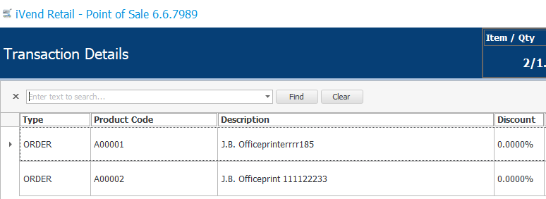

At POS , search the transaction which needs to be used for a refund and open it.
'Transaction Details ' screen will come up.

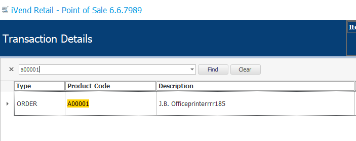

Press Ctrl+F and type the item that you want to search .
It will get highlighted and you can then use it for a refund
