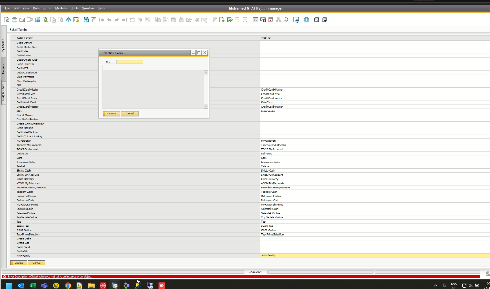

SAP Screen : Retail Tender shows the error “Object reference not set to an instance of an object.”
iVend 6.6 and SAP B1
Getting the error “Object reference not set to an instance of an object” in Retail Tender Screen on SAP while pressing the tab button in retail tender.

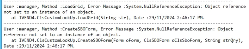

1. Check the error on the Add-on Log file

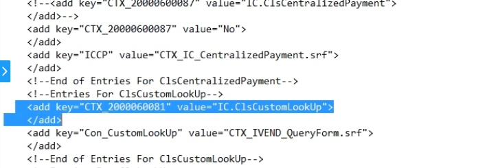

2. Check if Configuration was changed in the app.config file on the below location
C:\Program Files\SAP\SAP Business One\AddOns\CXS\CitiXsys iVend AddOn
Resolution/Work Around :
If Code is commented then un-comment the code and save the file and restart the SAP.
