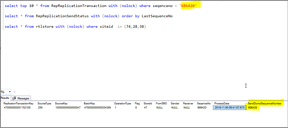

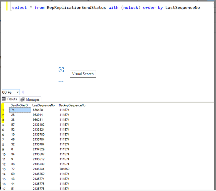

On executing the given query (present in screenshot) at HO, we found that last sequence no. of few stores (highlighted in yellow) were completely different to rest of the stores.
It means that these stores were either no more doing any transactions or have marked as deleted.

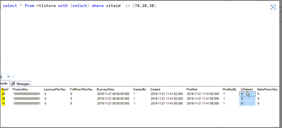

We have to confirm that if these sites have been marked as deleted by running the query below, and checking 'isdeleted' column, which is having value as '0' that is equal to 'not deleted'

Please look for the date of last replicated record using the Sequence no from SendStatus table and replication transaction table - to make sure that the stores not replicating records since a long time.

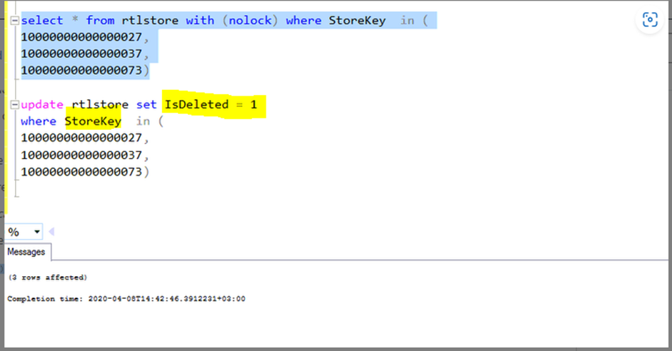

c.) Run the update query as present in screenshot below

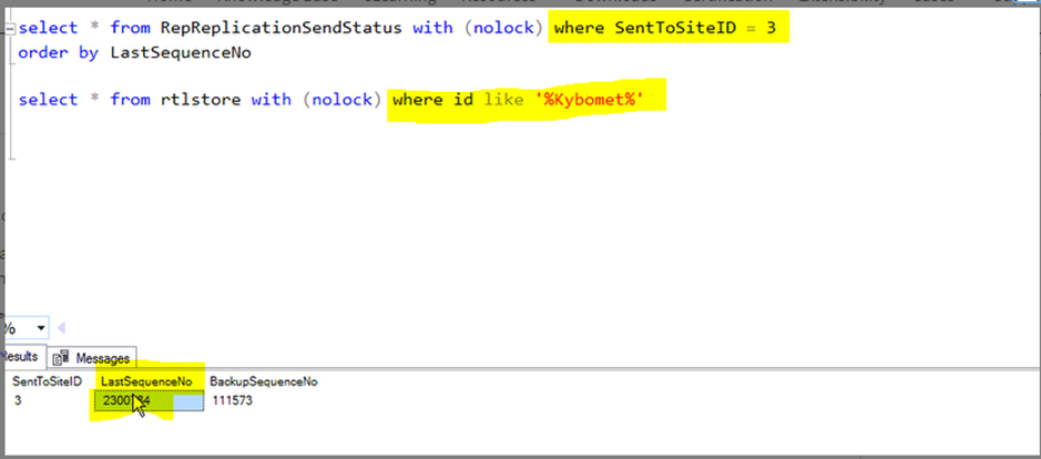

On starting the replication services, to check if the issue is resolved, please retrieve siteid of any of the stores (excluding deleted stores),
and run the first query, and hit it in interval of few minutes, if the lastsequenceno is increasing then the replication has started moving from HO to this store, and issue is resolved
