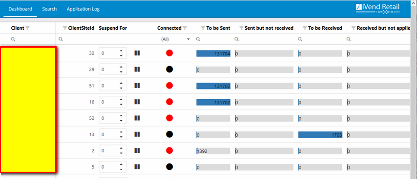

The customer has a problem with the connection status color of the stores. Replication connection status at the replication dashboard from stores to HO appears in Green but from HO to stores the status color is in Black.
Below are the screenshots for the same:
HO TO STORE: :
IIS WebSocket was installed on all machines but it still has the same color.
