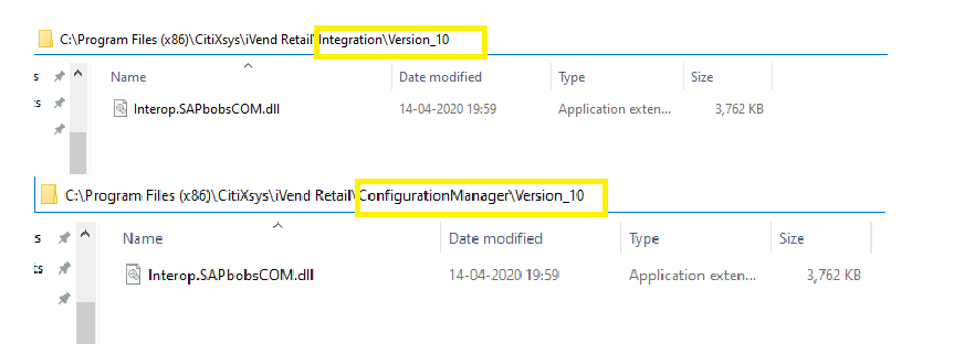

3) Version_10 folder (Interop.SAPbobsCOM.dll file was available in Version_10 folder) was available in Integration folder and Configuration folder (if SAP is 10.0 then this is required), below is the screenshot for the same:
