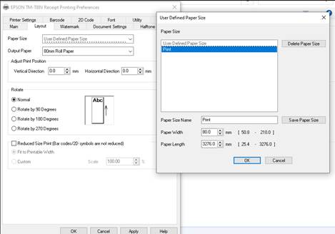

The printing issue was occurred due to incorrect layout and paper size setting in Hardware Printer.
Printing issue was resolved by making some changes in printer settings.
As per below screen shot, changes has been done in the layout of the printer and paper size setting in Hardware Printer.
Recommendations /Suggestion
For this kind of printing issue need to also check Hardware Printer setting.
