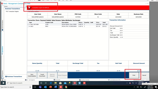

Problem statement :-
Getting an error "Transaction Report not Defined."  when trying to print the transaction receipt after doing transaction.
1.Log into the MC
2.Click on the Administration Tab.
3.Go to Retail Configuration.
4.Scroll down and click on Document Print Profile.
5.Click [F3 New] and fill in the form
6.Then map the Transaction Receipt using the lookup function (….) for the field value "TransactionDetail".
