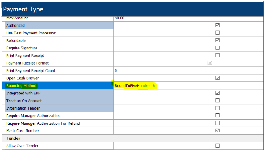

Problem Description:
Client encounter issue where the payment at POS was not rounding over as per set in the MC. We have set the rounding method to RoundToFiveThousandth but, when making payment at POS, it does not reflect.
Referring to below transaction, the paid amount should be RM184.75 instead of RM184.73
1) Check the Payment Type Rounding method defined at HO MC.
2) Change it to Five hundredth option.
3) Check the payment it shows round figure correctly as required.
N/A.
After changing the Payment Type Rounding method to Five hundredth option system is showing the correct figures.
