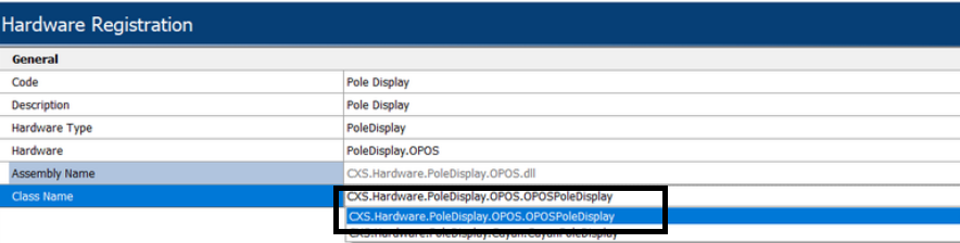

After configured the customer pole display in POS system an below error displayed “Invalid URI: The hostname could not be parsed”
 iVend 6.6 integrated with SAPB1
This issue generally occurs due to wrong class name in hardware registration pole display configuration so suggest to delete the hardware registration for Pole Display and select "OPOS pole display" from class name drop down. Please find attached screenshot for reference
