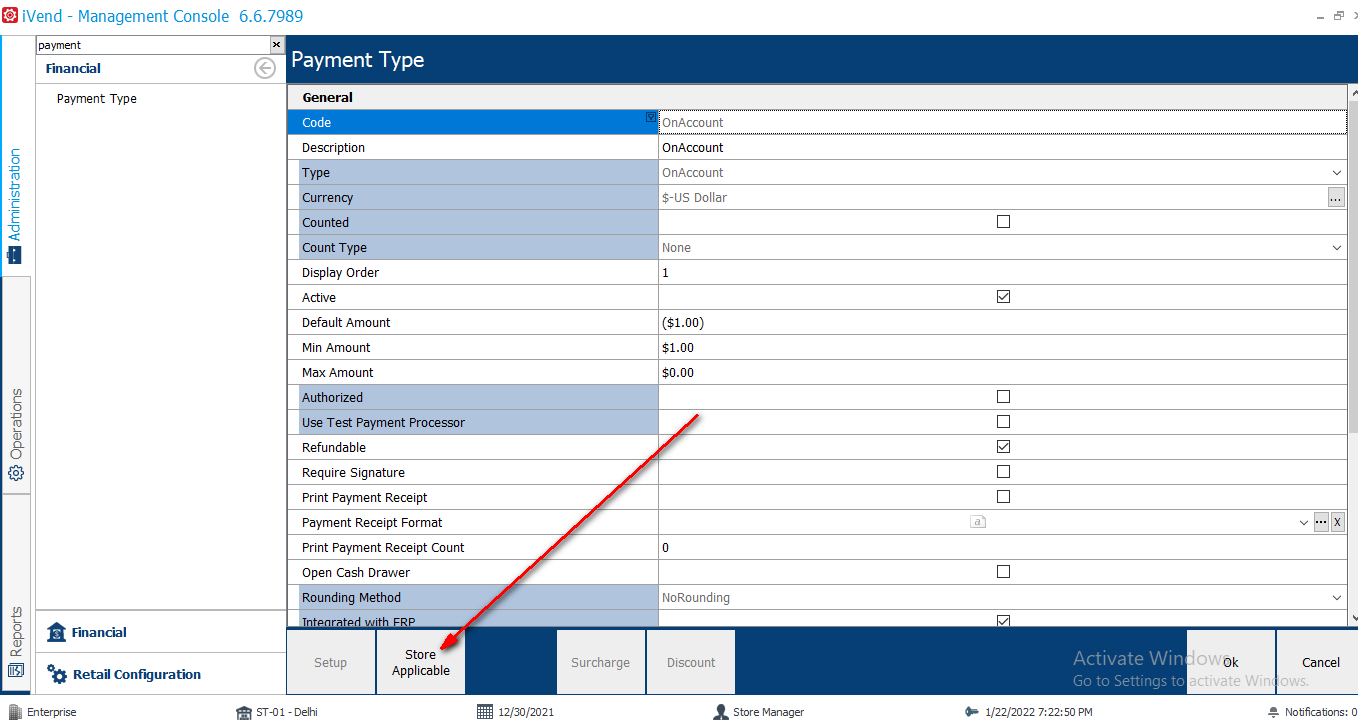

Please check problematic store is mapped with the concerned payment type or not.
1. Open HO Management Console.
2. Administration > Financial > Payment Type.
3. select the Payment Type and open in edit view.
4. Click on store applicable.
5. Add the store where payment type is not showing while completing the transaction.
