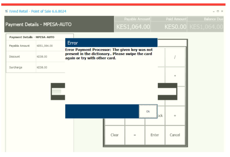

One of the Customer was facing an error with a custom payment processor. Getting below attached error.
The Payment processor has been working well on other installations but having issue on patch 8024.
Troubleshooting Steps followed
1. Checked the POS error Log and found below error message.

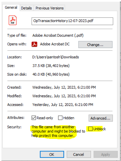

3. We checked if file was copied from other system or location and having permission issue as per below screenshot but it was found ok
