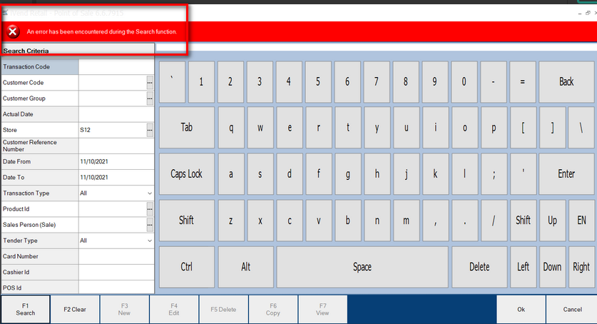

When searching the transaction at POS an error message appears
"An error has been encountered during the search function"
Below is the screenshot of the error:
