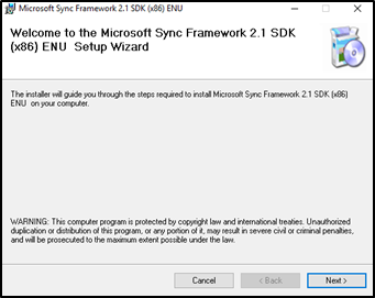

On selection of the option, a confirmation message window will pop-up from the system, and when accepted, the Microsoft Sync Framework will be installed for the Offline POS feature, which will help to synchronisthe data with the Store server.

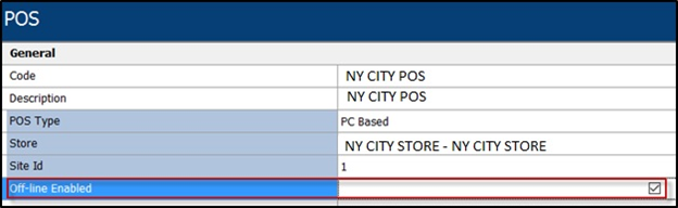

After enabling Offline Store, you will then have to enable a POS to run in Offline mode. To do this, you will have to select the checkbox, “Off-line Enabled” in the POS setup screen (see highlight in the image below). To enable this, go to: Administration > Retail Configuration > POS, then open the POS, which you wish to enable for Offline mode functionality.
Note: - Click on the  [Custom Series] button from the button panel to define custom series for offline Customers, which will be created at the POS. Furthermore, when you save the POS screen, the document number series window will pop-up to define series for the transactions that will happen from the Offline POS.

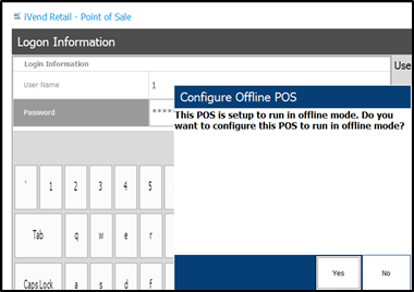

When you run the POS application for the first time in Offline mode, it must be with the “Run as Administrator option. You will see the selection message such as below as to whether you want to run the POS in Offline mode or not.
If you select [Yes], then you will be presented with a pop-up screen to select between two options; select accordingly and continue.

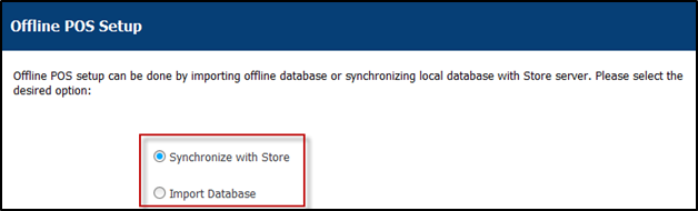

There are two (2) options to setup the Offline database that will be maintained at the POS local database:
· Synchronize with Store – If you choose this option, then sync happens with the synchronisation service known as the POS Synchronisation Service, which will sync the data between the store DB and POS local DB.
· Import Database – If you choose this option then you need to take backup from the Management Console, transfer it to the POS machine and then select this option to continue.

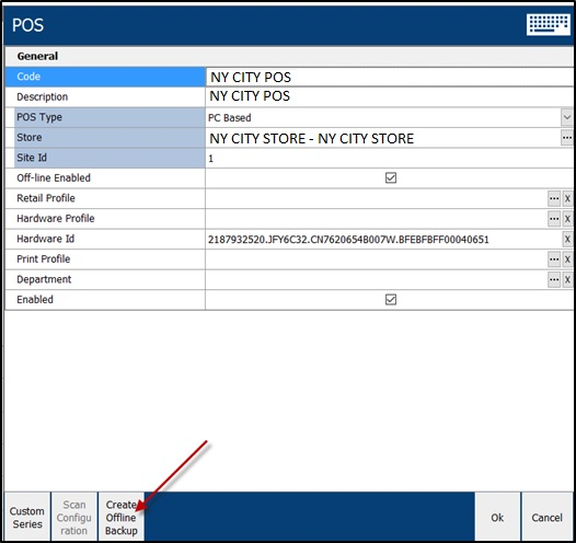

Note: - If you wish to choose the Import Database option, then you need to perform a backup from the Management Console using the [Create Offline Backup] button in the POS screen as shown below. Save the backup file, then browse to this file on the POS machine. Select the Import Database option and choose the file location to restore the database.

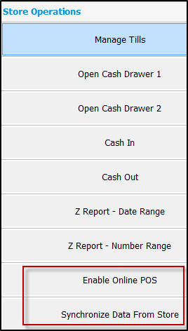

POS User Menu – Two New Menu Options
There are two (2) new menu options under Store Operations located in the User Menu of the POS (see below).  Here, you can switch back to Online mode by using the menu option, “Enable Online POS”. The other menu option is “Synchronize Data from Store, which is used whenever a synchronisation of the data from the Store is required.
