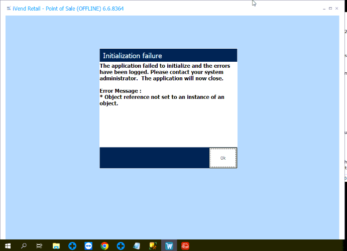

Problem statement
After Reinitialize Offline POS Machine get error "Object reference not set to an instance of an object"
 iVend 6.6  and SAP 9.3
  After restoring the database, while try to open the OPOS, it started to show the error.

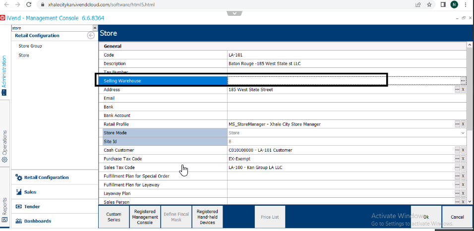

Warehouse is not assigned to the store to which the POS belongs to, suggest to assign the warehouse to the store.
