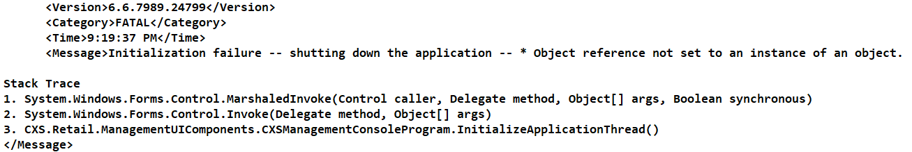

After following above troubleshooting steps and checking Management Console Logs, below steps followed.
Below message was coming in Management Console Log
1. Tried to replace the ManagementConsole folder from HO to the problematic store.
2. Store re-initialized again with fresh schema backup from HO MC.
Store re-initialized again with fresh schema backup from HO MC solved the problem of “Object reference not set to an instance of an object”.
