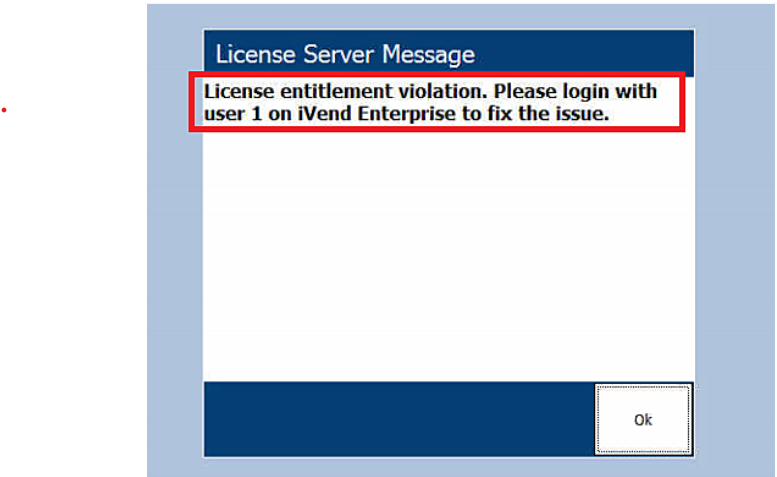

Not able to login at MC. Error "License entitlement violation. Please login with user 1 "
Problem:
Users not able to login to Management Console due to error "License entitlement violation. Please login with user 1 on iVend Enterprise to fix the issue" as shown below:
Cause:
Below are a few of the know reasons causing this issue.
  1. This error is usually caused by having more records (e.g. warehouse, stores or users) created than the license entitlement allows.
  2. Non Licensed features are configured in the system. E.g. Handheld Devices.
  3. Specific store reports the issue after a change /update in the license at Enterprise server.

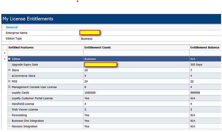

 Investigation:
As a very first step, you need to review the License Entitlements for the customer.
This can be verified from the “My License Entitlements” screen. This can be accessed from the below path.
 Management Console >Administration>IT Administration
(Sample Screenshot)
