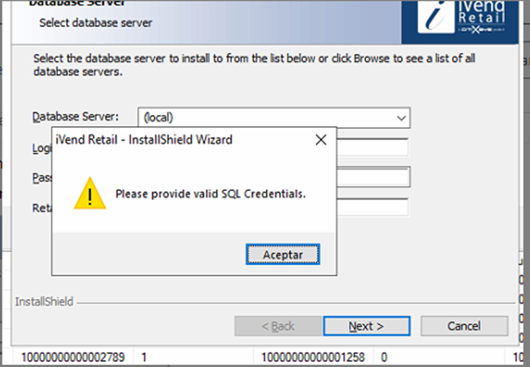

Not able to install iVend on a store server it shows an error about SQL credentials.
Even after all the sql credentials is correctly entered (error shown in below image)

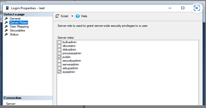

  1. Make sure the Database user has admin rights.

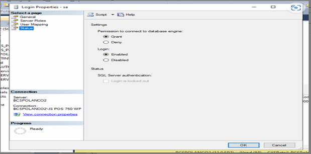

  1. Make sure that status of the user is enabled or not if not make it enabled.
