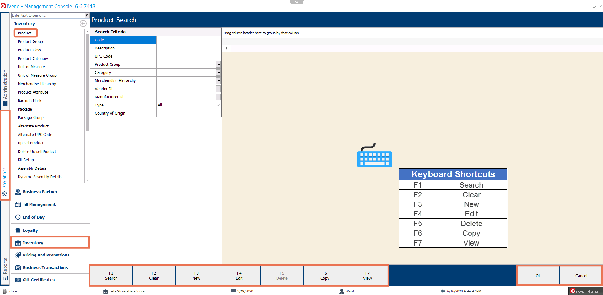

Log into the iVend Management Console and navigate to: Operations > Inventory > Product – the Product Search screen comes up. Select a Product and press [F4 Edit] to bring up the product’s setting page.
Figure 1 – Product Search Screen

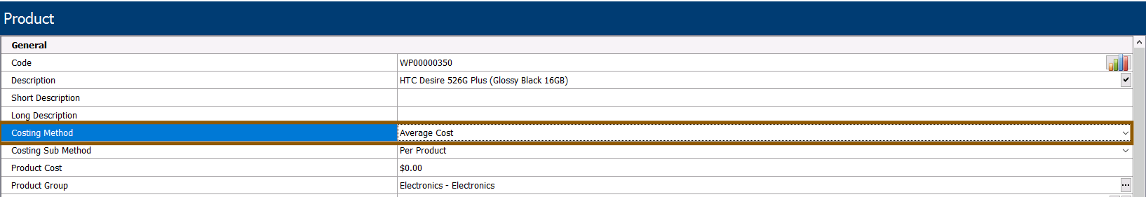

 Product costing method should be set to either Average Cost
Figure 2 – Product Master Screen (Average Cost)

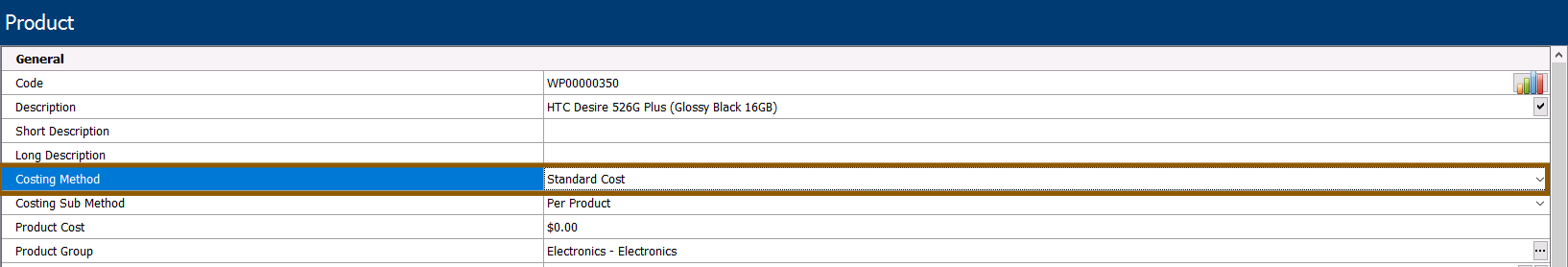

or Standard Cost
Figure 3 – Product Master Screen (Standard Cost)

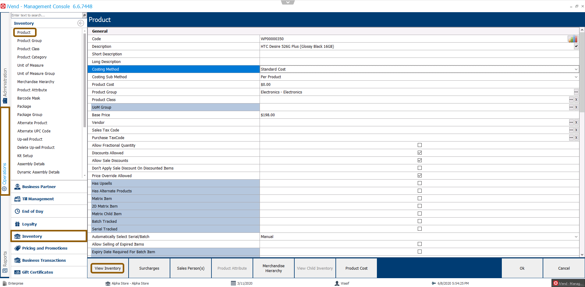

Within the Product setting screen click the [View Inventory] button.
Figure 4 – Product Master Screen

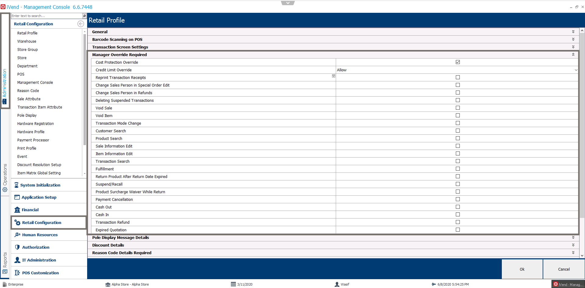

3. Manager Override Setting

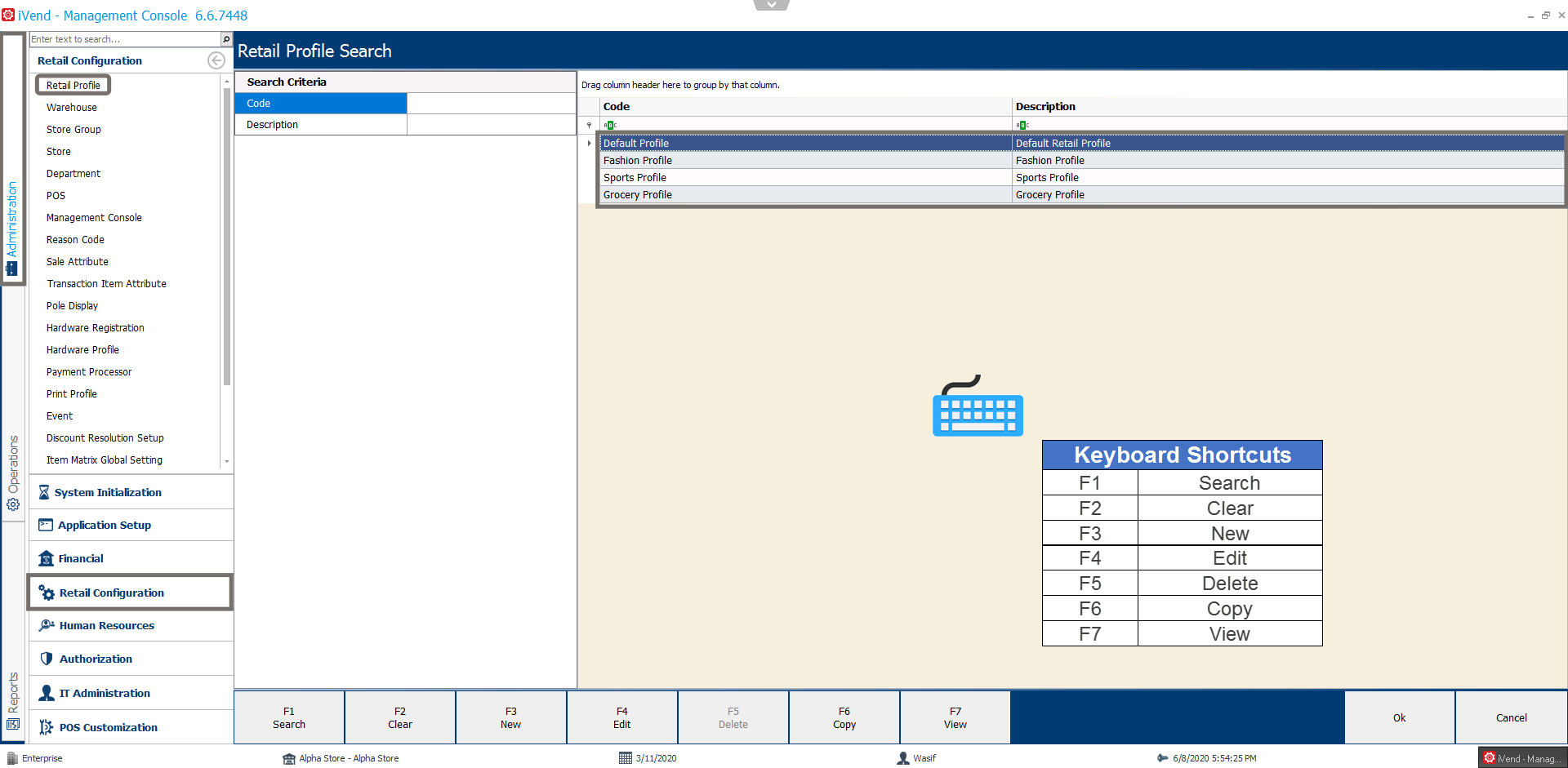

Log into the iVend Management Console and navigate to: Administration > Retail Configuration > Retail Profile – the Retail Profile Search screen comes up.
Figure 6 – Retail Profile Search Screen
In the Manager Override section, check the box “Cost Protection Override” to ensure that it is enabled. Press [Ok] to update the changes made to the Retail Profile.
Note: Changing the Retail Profile settings will require a restart of the Management Console and POS applications before the change will be applied in the system and become into effective.
Figure 7 – Retail Profile Settings Screen

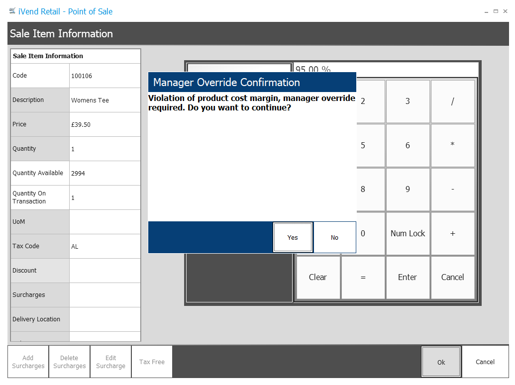

When selling products at a discount at the POS that would result in the price dropping below the threshold set for the margin control parameters, the Cashier will be prompted as follows:
Figure 8 – Manager Override Confirmation Screen
Selecting [Yes] will require the manager to log-into the POS so that the discount can be allowed. Selecting [No] will return the cashier to the discount screen where the discount would need to be reduced to a value that is below the threshold trigger set for the margin control on the product.
Note: If the Manager Override setting for Cost Protection Override is not set in the Retail Profile, then the discount will be allowed regardless of any other Cost Protection settings defined in the system.
