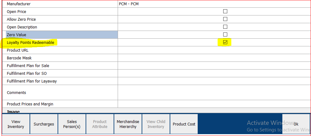

1) Check that for the POS Transaction whether the Loyalty points Redeemable option is enabled or not for the products which are used in POS transactions if it is not enabled then please enable it and then check whether the loyalty points as well as amount is coming for redemption or not.

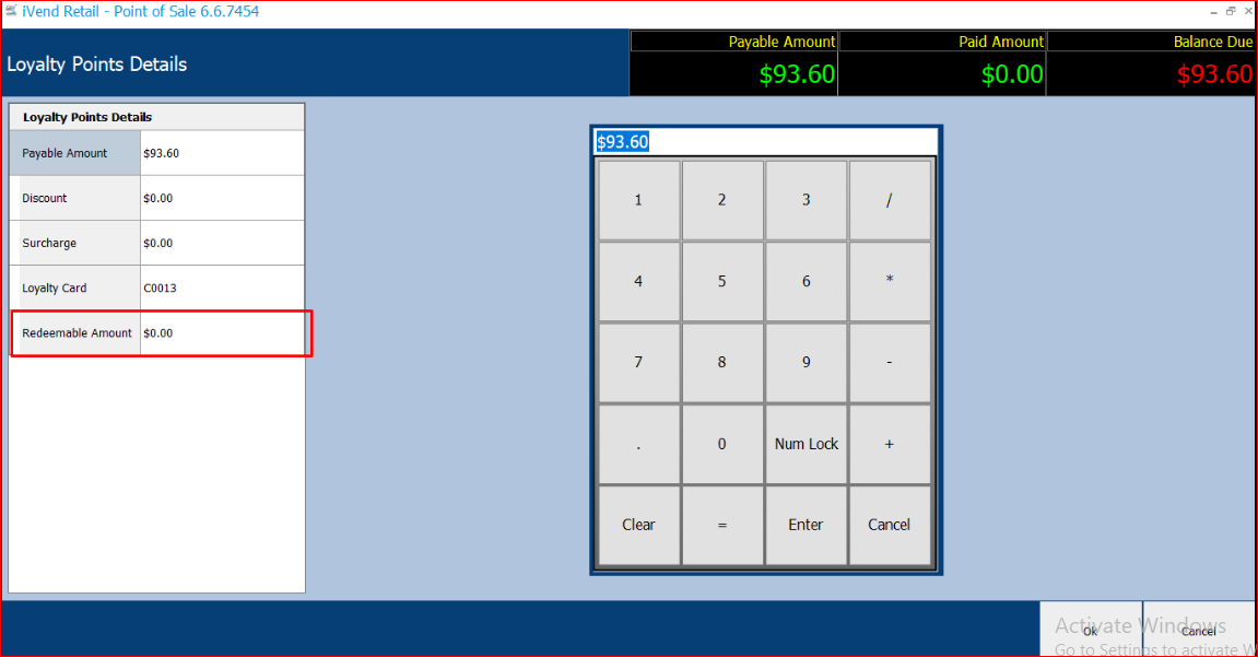

At the time on POS transaction the Redeemable amount is showing 0.

Screen 2:
On POS Transaction the Loyalty amount is coming 0.
Enable the Loyalty points Redeemable option for the products which are used in POS Transactions and then check whether the loyalty amount is coming or not.
