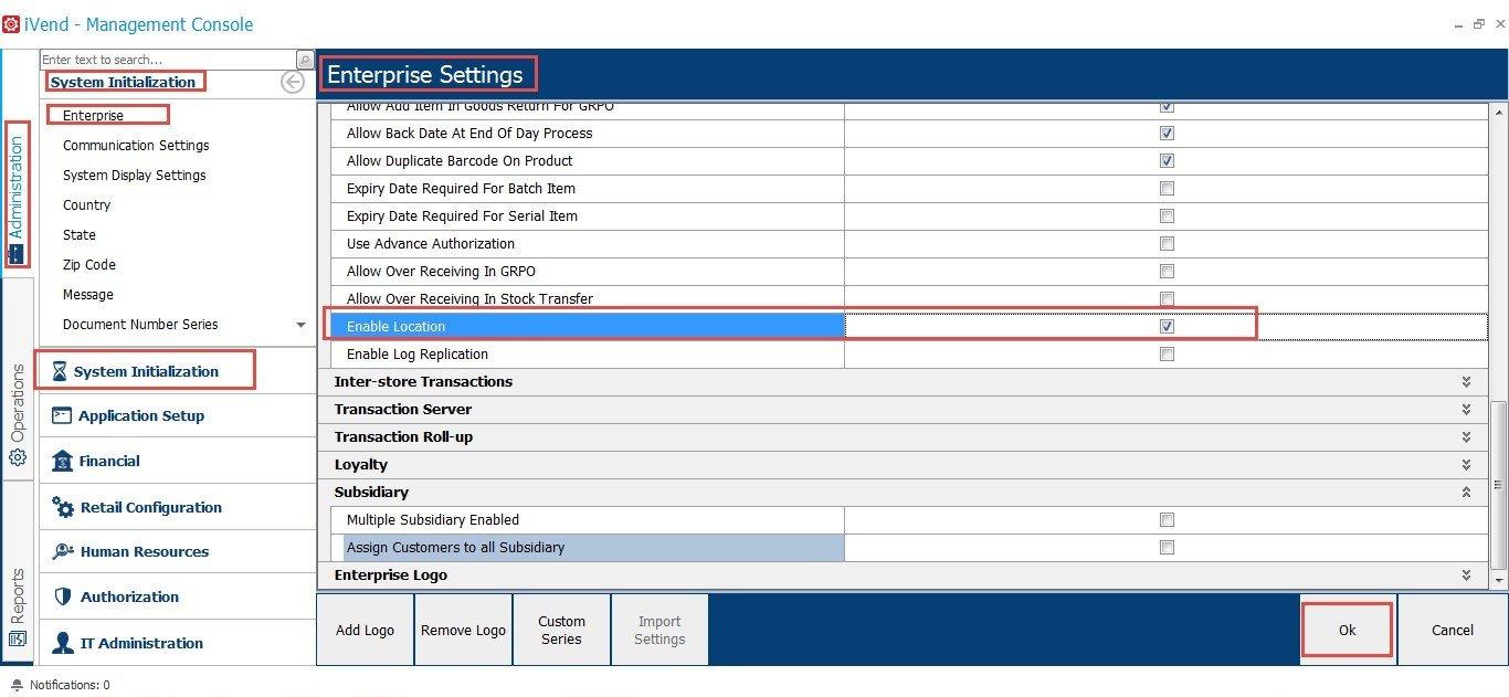

1. Enterprise setup: At the iVend Enterprise, we need to enable the Locations option
Path: Administration > System Initialization > Enterprise
Figure 1 – Enterprise Settings
· Check the option, Enable Location and click on the [Ok] button to save the settings.
· Restart the system so that the required changes will be applied.

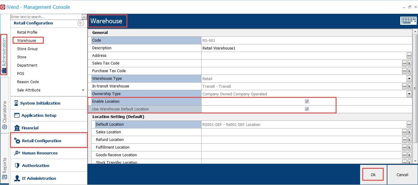

2. Warehouse and Store Setup: Enable the Locations at the Warehouse level
Path: Administration > System Initialization > Retail Configuration > Warehouse
Figure 2 – Warehouse
· Check the option, Enable Location to enable Locations for this Warehouse.
· Use Warehouse Default Locations is an optional check, and this will allow the default Locations to be applied automatically within the transactions.

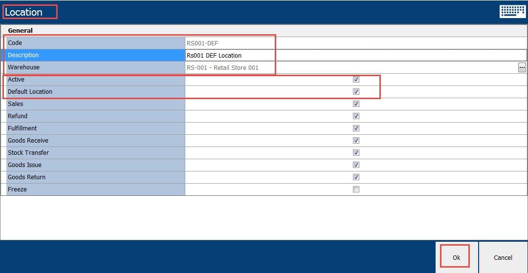

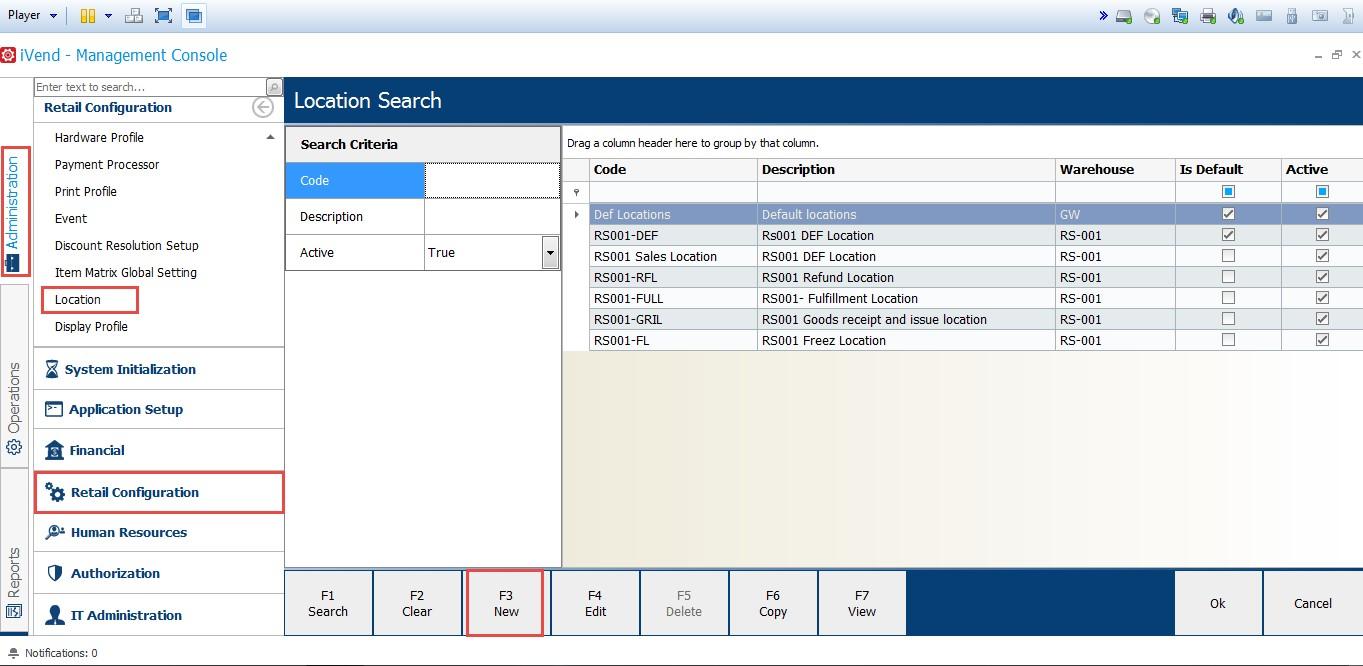

3. Create Locations and link them with the Warehouse
Path: Administration > System Initialization > Retail Configuration > Location
Figure 3 – Location Search
· To Create locations, click on the [F3 New] button.
Figure 4 – Location Settings

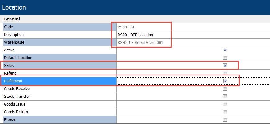

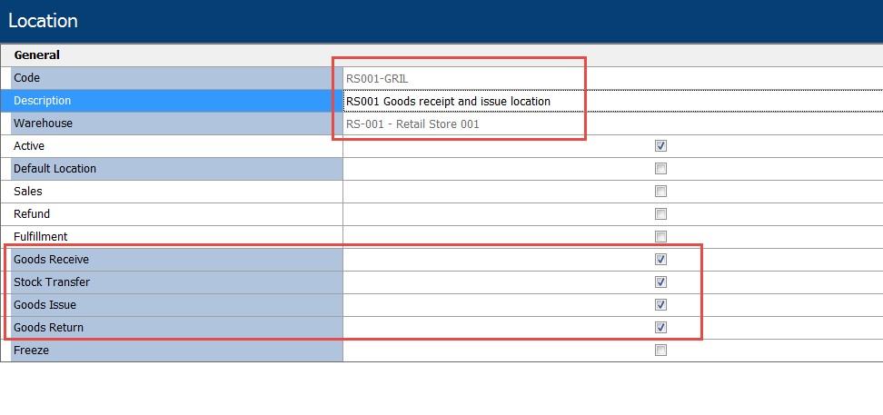

· Create a Location and give it a code and description as needed.
· Select the Warehouse that will be mapped to this Location.
· The Location should be Active and marked as the Default Location option, all other check boxes will be marked automatically except the Freeze option as it cannot be marked with the default Locations.
· Click [Ok] to save this Location and then repeat the same steps for all other Locations needed.
In our example, we will create the following Locations:
a. Sales and Fulfillment Location
Figure 5 – Location Settings

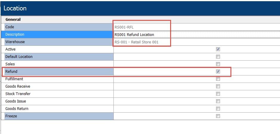

b. Refund Location
Figure 6 – Location Settings
c. Receive, Issue, Return, and Transfer Location
Figure 7 – Location Settings

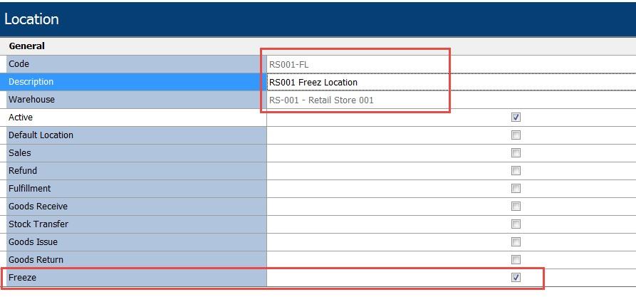

d. Freeze Location
Figure 8 – Location Settings

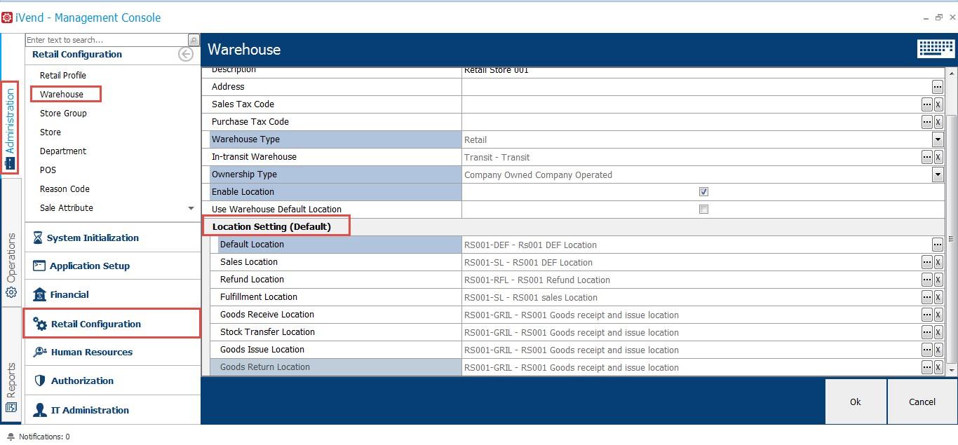

Figure 9 – Warehouse Settings
· Link all default Locations to the right Location that will become as the default in the transaction.
· Click [Ok] to save.

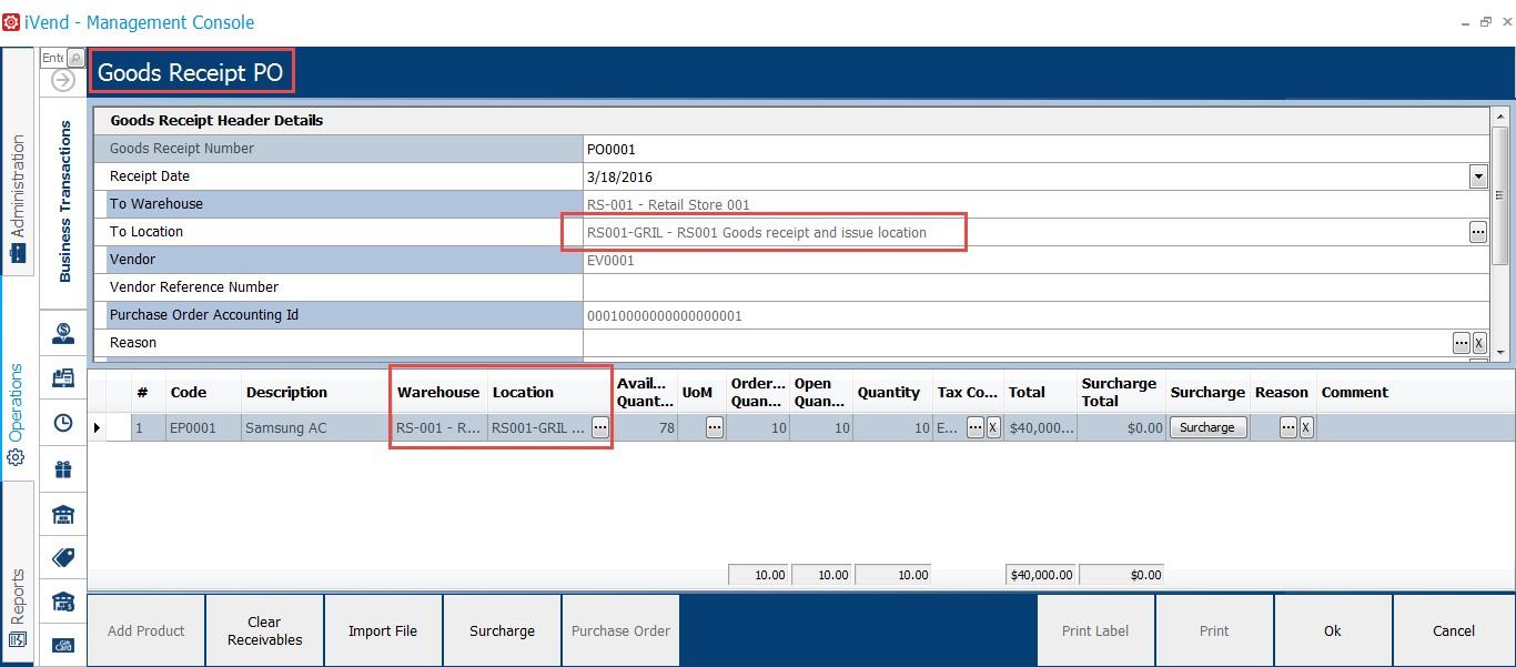

We have a Purchase Order created to a supplier, and the supplier has shipped the required product(s) to our Warehouse where the warehouse team can start receiving the product(s) to the Receiving Location by choosing the Location in the Goods Receipt PO form.
Figure 10 – Goods Receipt PO

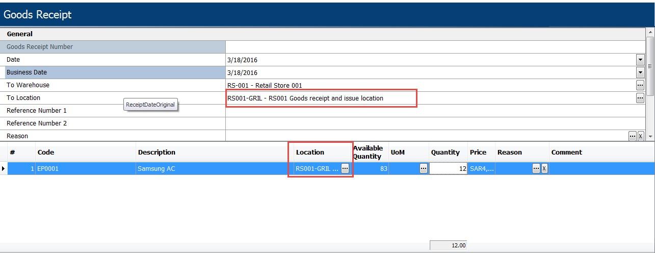

In a Goods Receipt, the user can select to which Locations the product(s) will be received.
Figure 11 – Goods Receipt

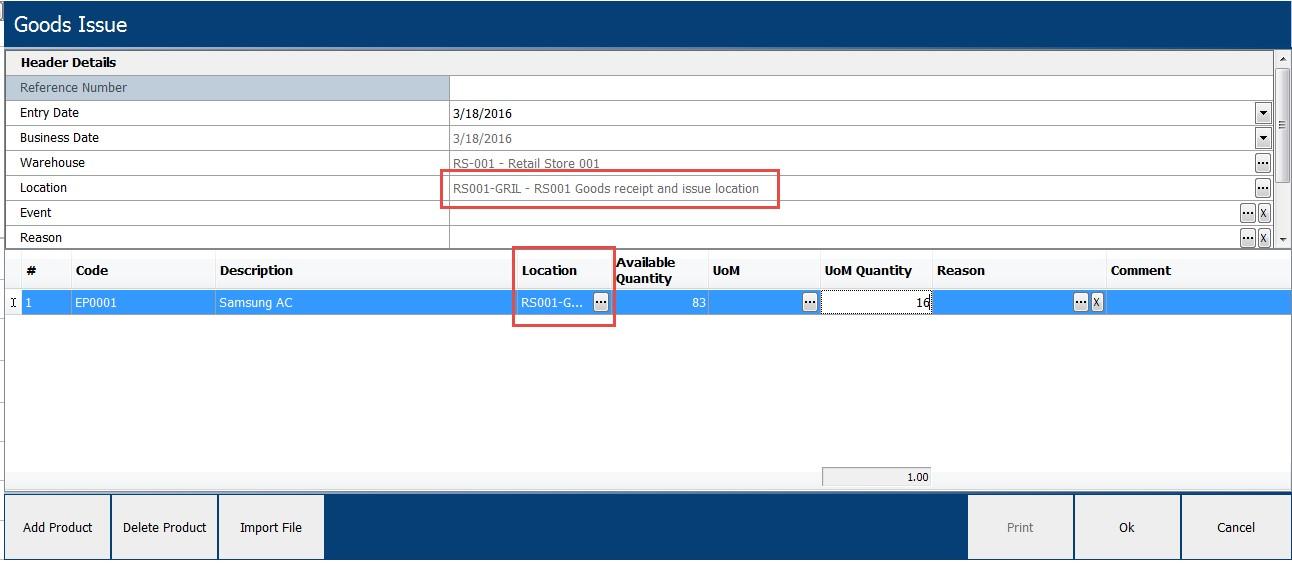

In the Goods Issue, the user can also select from which Location the product(s) will be issued from and the transaction document will be printed with the Location name.
Figure 12 – Goods Issue

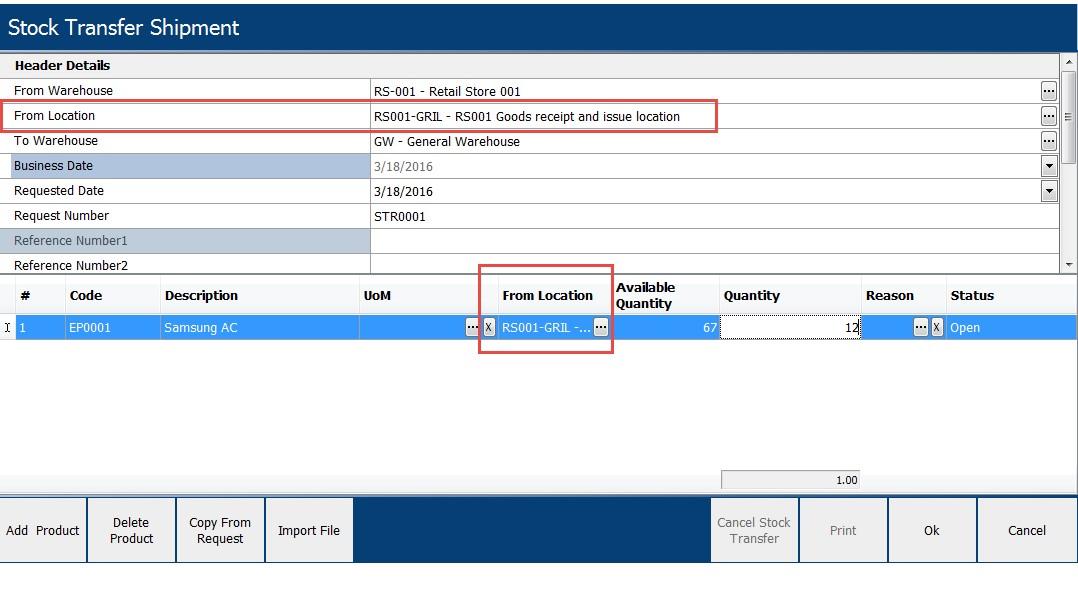

The user can select from which Location the product(s) will be shipped and to which Location they will be received.
Figure 13 – Stock Transfer Shipment

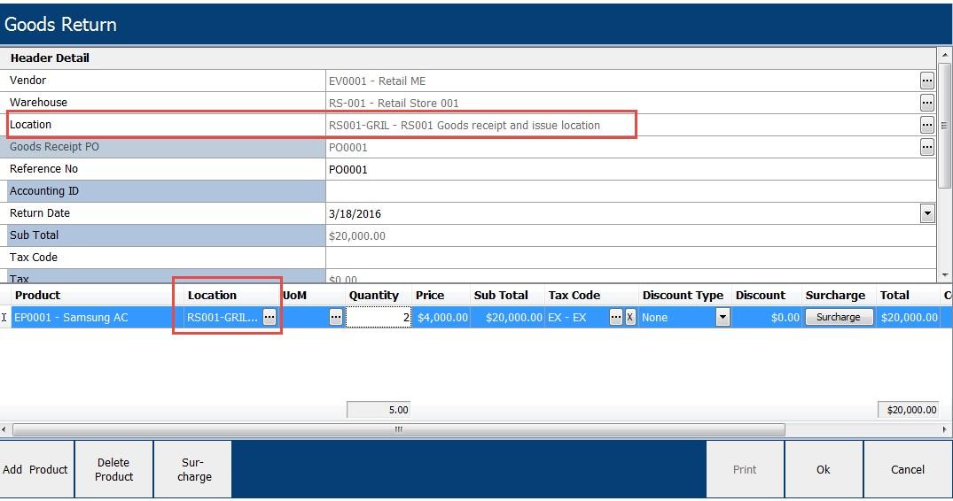

The user can select from which Locations the Goods Return will issue the product(s) back to the Vendor.
Figure 14 – Goods Return

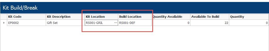

The user can select from which Location the build components will be issued and to which Location the Kit will be received.
Figure 15 – Kit Build and Break

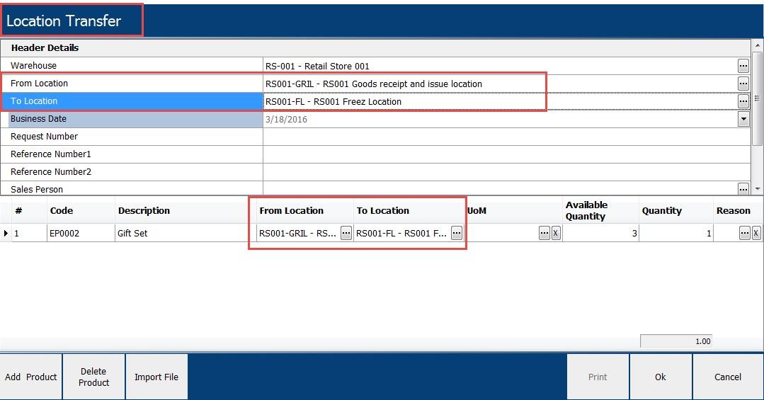

To transfer products from one Location to another, use the Location Transfer form.
For example, transferring products to the Freeze Location from the Receiving Location as we see in the following screen image.
Figure 16 – Location Transfer

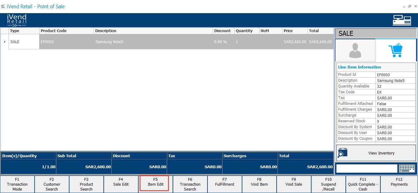

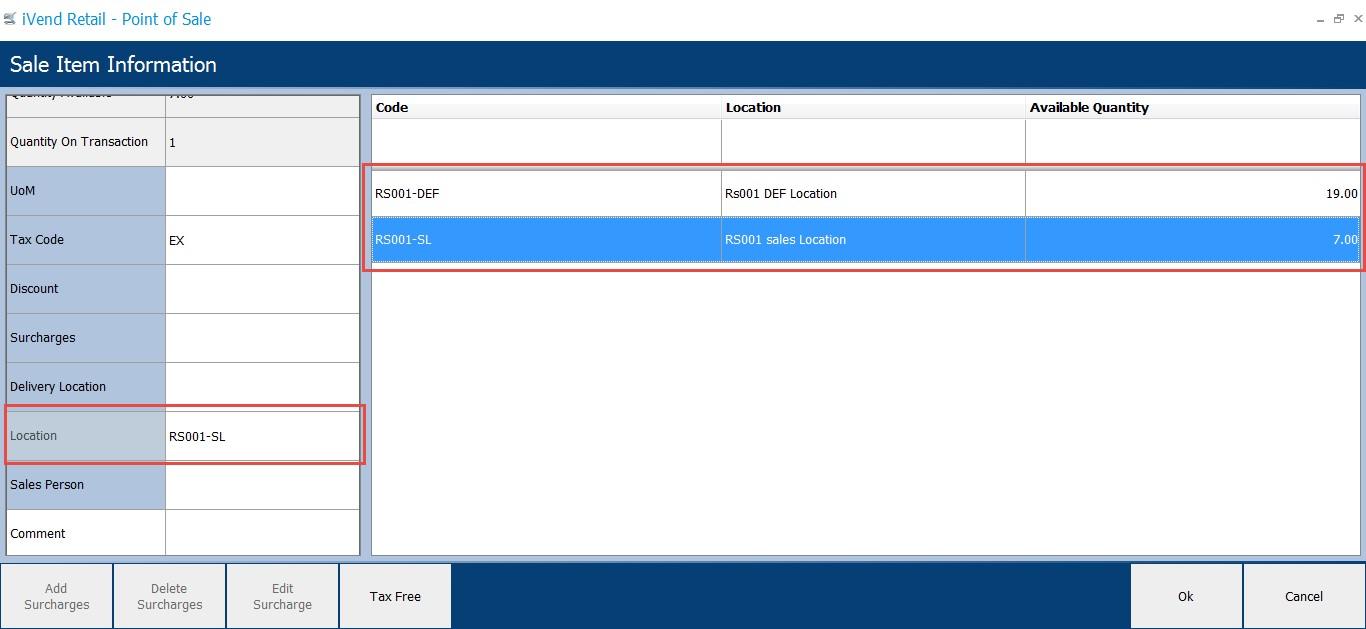

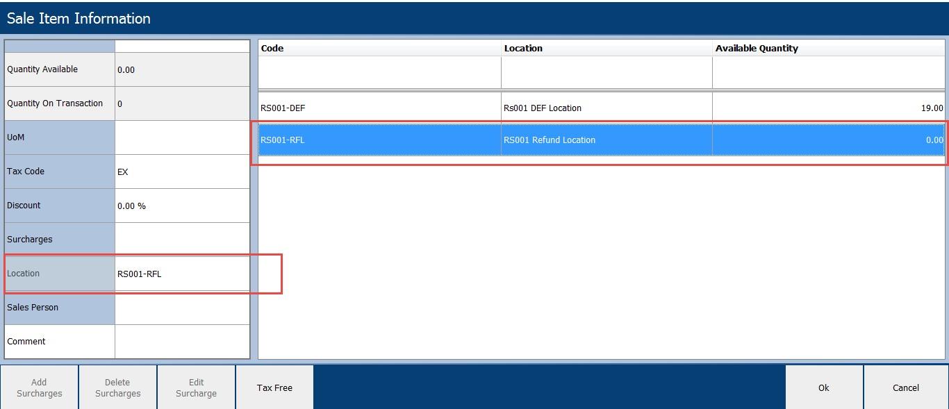

At the POS, the system by will use the default Sales Location, then the user can choose to sell from any other Sales Location at any point of time by choosing the [F5 Item Edit] button and by then selecting a different Location from the Item Information screen.
The same will apply to all other sales transactions at the POS.
Figure 17 – Transaction Screen
Figure 18 – Sale Item Information Screen

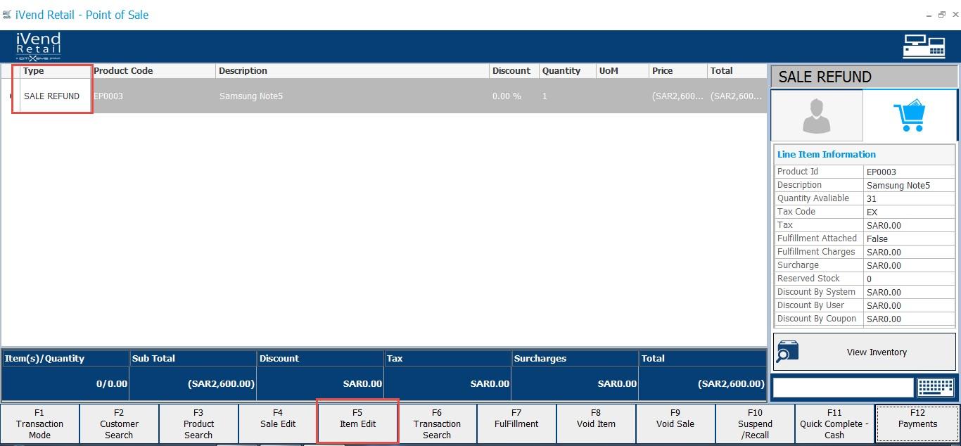

In the Refund transaction, the system will use the default Refund Location to receive the returned items from the customer however, the Location can be changed from the Item Information screen by clicking on [F5 Item Edit] button.
Figure 19 – Transaction Screen
Figure 20 – Sale Item Information

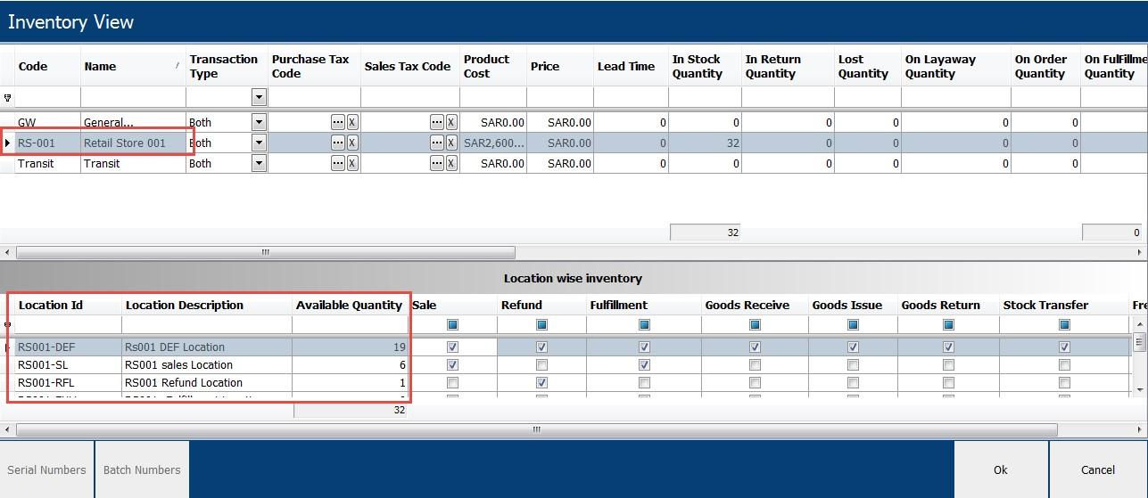

Using iVend Retail versions 6.5 and above will allow the users to view the inventory by Location. The user can access the Inventory View from the Product master at the Management Console and from the POS.
Figure 21 – Inventory View

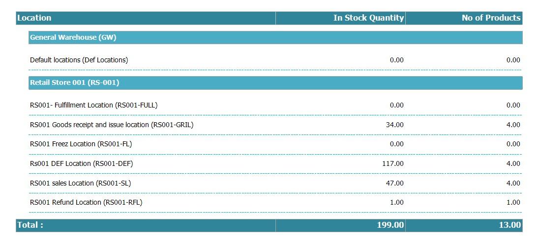

The Location List report displays all the Locations, the total quantity and count of distinct items.
You can narrow the report's output results by passing a filter value on the following parameters:
· Location
· Warehouse
· Product Group
· Product
· Subsidiary (Note: This parameter filter will only be available if the Subsidiaries functionality has been enabled in the system).
Figure 22 – Location Summary

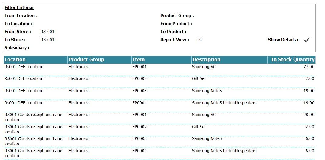

The Stock by Location report displays the Location wise product stock. The report can be viewed in the following ways:
· List - Displays the Stock per Location per item
· Hierarchical - Displays the stock details in a hierarchical structure:
· Product Before Store - Product data is displayed before the store data
· Product After Store - Product data is displayed after the store data
· Location
· Store
· Product Group
· Product
· Show Details : Displays the serial/batch information
Figure 23 – Location Summary
